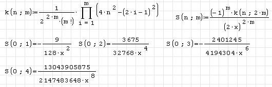

(see attachment). It is working very well so far, but now I want to increase the precision a liitle bit by adding one or 2 summands to his P and Q polynoms (see attachment) But unfortunately I don't fully understand his notation form not even though he is describing it. (sse attachment)

Try this. I just literally defined the functions and it seems to work.

Dear mKraska,
you have saved my day. Thank you very very much.
Now I also can understand the notation. I really got stuck here before.
