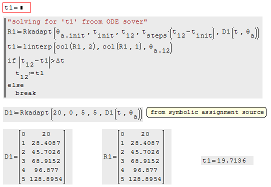

I have tried to apply that approach to selectiong solvers, but my results does not come out correct..

#86 Опубликовано: 31.10.2020 13:16:19
1402 сообщений из 1708 понравились пользователям.
Also, I have tried manipulating ZedGraph setting with the setprop(), but I cant get it to work with existing plots.. only new plots.. any ideas?
setprop() is experimental and I will add differ method to control region properties (using math variables as values for them). Yes, now it works only for new plots with 'zGraph' name. But you can't save this value with the document. This is because region has binary content in xml file and for now I can't change it by adding new properties.
I am not the author of the component, so it is difficult for me to modify it.
As for the solver I hope someone can suggest a solution.

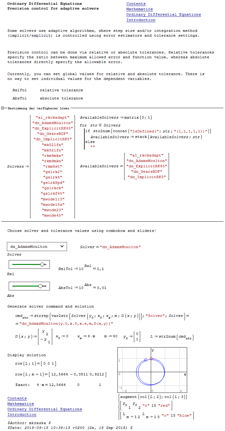

After recently learing how to write for loops, this forgotten project popped back up in my mind again..
My newfound knowledge got me quite a bit further, to the point where i think this project is complete as well.
Just one question - is it possible to define a function quickswitchODEsolver(a,b,c,d,e)=ODEsolver(a,b,c,d,e) <-- This could be Rkadapt() for example, or maybe another solver.
Can the 8 different resolutions then be solved by quickswitchODEsolver()?
The goal is to have to change the solver function only one place rathere than 8, if I want to switch.
Cheers.
Temperaturforlop.sm (119 КиБ) скачан 58 раз(а).
There might be smoother ways but this works. Note that I had to replace the sliders because the old regions don't seem to work any more with new SMath versions.
Section Math ODE precision.sm (23 КиБ) скачан 55 раз(а).
