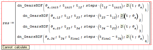

hanskl
hanskl
7 сообщений из 158 понравились пользователям.
I have added some graphic illustrations to highlight what is going on with some of the variables..
All the graphs down to the DE solvers work fine ... but
======== the suite of 6671 is not compatible with 6179 ========
Simply disastrous that dn_GearsBDF 6179 is not compatible 6671.
The suite 6671 looks correct, sorry for this handicap.
Maybe more collab will terminate checking.
Cheers Hanski ... Jean
Temperaturforlop i isolerte stalkonstruksjoner ved brann page2.sm (57 КиБ) скачан 57 раз(а).
Jean,
I must be missing something.. I tried to downgrade to suite 6671, and dn_GearsBDF still tells me it cannot calculate.
I don't understand why the DE cant handle e^ø. Or have I constructed the DE wrong?

#71 Опубликовано: 07.05.2018 10:22:45
Jean,
The books style are very difficult to put it executable.
Your DE setup looks quite correct: proof the first one works
but the 2, 3, 4 "Division by 0". It must have to do with the
meshing of the Solver. It does not like something in there.
Should work in your latest 6671.
I simply reconstructed piece wise, simplified, on my 6179.
See U tonight ... Jean

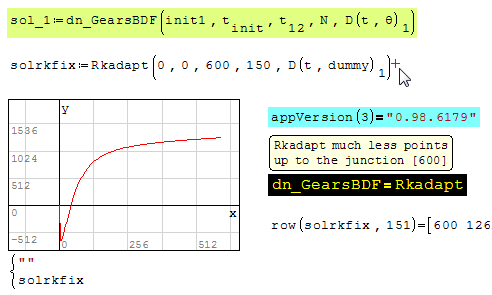

#73 Опубликовано: 08.05.2018 00:47:40
Jean,
I can not get it to work in my current version of Smath.
Is it possible another solver has to be used? One of the Runge-Kutta versions maybe?
You are quite right though, the fact that the first of the four equations work on your sheet suggests that it should work. However, that values in the solution you posted is quite wrong... Not quite sure why that is though, has to be something with the input.
I'm quite curious as to what the workaround/solution to this project will be. Looking forward to seeing what you will come up with
Hanski,
A bit of headache
Those solver may fails ... guess the cause "Division by zero".
You should have the first segment running as the picture.
Just to show how difficult it could be, read the ODE Yuk.
Temperaturforlop Compactum.sm (60 КиБ) скачан 60 раз(а).

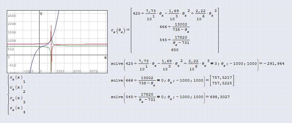

#75 Опубликовано: 08.05.2018 03:36:45
hanskl
hanskl
Jean,
Hanski,
A bit of headache
Do you have a link to that text?
All the solutions works just fine if the last part e^ø(theta) is neglected. The DE solver can handle ø(theta) in the first part of the expression.
As a matter of fact, if the last part of the expression is altered to e^ø(t), the solver can handle that too. Of course the results are wrong, but it might suggest that the thing that the solver dislikes is the fact the e^ø is dependent on theta.
Is Mathcad able to handle this DE? Can anyone try to solve it there?
PS: I still cant get the original sol_1 to calculate in my version of Smath. It just tells med "Cannot calculate". If you get the error "Division by zero", maybe you can try to modify the IC's a little bit? From 600 to 595/605, from 735 to 730/740 etc.
Best regards,
Hans Kristian
Edit:
Does sol_4 work for you? It should work considering Ca is constant for this solution.
#76 Опубликовано: 08.05.2018 08:12:25
... Oh ! it didn't upload.
17 solvers, only rkfixed responds at very specific 'N'
ODE Yuk.sm (27 КиБ) скачан 60 раз(а).

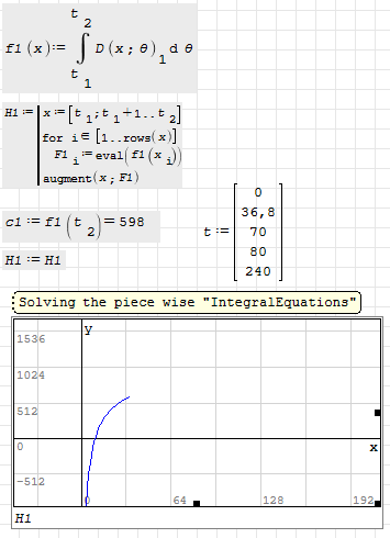

#77 Опубликовано: 08.05.2018 22:44:00
I doubt because rkfixed, Rkadapt are same.
The first segment maybe ? from the "Stiff option"
Good news is that the project has an elegant solution.
It consists in solving the Integral Equation
Will post it before bed time ...
#78 Опубликовано: 09.05.2018 00:03:51
... maybe there is some applicable scaling factor ? ?
Temperaturforlop Compactum Copy.sm (48 КиБ) скачан 52 раз(а).

#80 Опубликовано: 09.05.2018 10:55:01
But from the top of my head - the X-axis should represent time in minutes, not temperature.
Also, it took quite some time for the sheet to finish calculating.
Best regards,
Hans Kristian
1. You can leave it in native 't'
2. the default Integration accuracy is 100, set it 50
it will have no influence in this application but much faster.
1.7 min in my 1.66 GHz laptop runs 225 greedy maths.
3. Does your version bracket t:=[0,5..600] ?
rather than Smath 6179 t:=0,5..600
Temperaturforlop Compactum Copy.sm (53 КиБ) скачан 57 раз(а).
