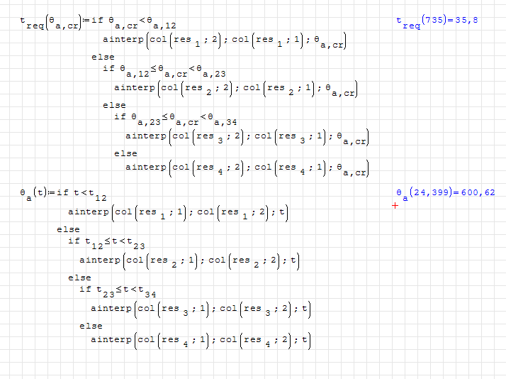

#43 Опубликовано: 29.10.2017 19:45:31
Does that mean that you think the last approach i did is the best way to solve the problem? The trick i think is to establish boundry conditions for ODE2,3,4 which is done by iteration till t.xy in the input box matches t.xy in the calculation after all the constants is established
Radovan is right: the functional relationship is in term of finite differences,
i.e: for pre-computer age. In fact you just need to integrate the RHS member.
You could think of the integrator operator, that would be a great mistake
on two counts: the operator is horribly slow and may be unusable wrt accuracy.
The "RK" integrator is hyperfast [probably from borrowed code] and accurate.
The other question is if RK supports conditional ... answer is YES
The attached confirms, unfortunately a single conditional.
I don't understand the conditional of your project.
@ 735 °C, steel is pink, visible in the dark, soft, not black smith works.
@ 900 °C, red hot for forging. Why is the conditional infinity @ 735 ?
Just observation(S) ...

#45 Опубликовано: 30.10.2017 11:23:34
... finally, your project is completely correct as it looks.
Observe few modifications to get equally spaced data result,
1. re-arranged the number of points
2. submatrix to get rid of duplicates
3. spline "global"
4. discretise 1,2,3 ... or at will as you wish.
Saved in my personal file, thanks ... Jean
ODE Multiconditional [Steel fire].sm (37 КиБ) скачан 68 раз(а).
sergio 30.10.2017 11:47:00

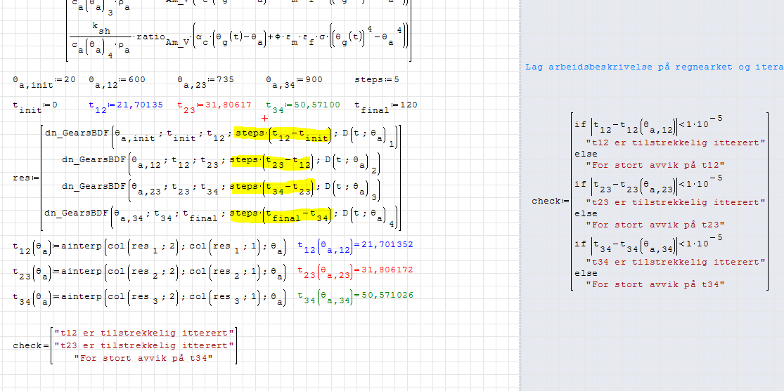

#46 Опубликовано: 30.10.2017 14:15:47
... two pages of Engineer's stuff has been added [page: 3, 4]
The two solvers are fully automated, i.e: given Y on the red curve
they both solve for their respective values on the X axis.
The function 'θ(t)' does not have an explicit "inverse". No problem
for solving with the Smath solve bloc. We can solve both iteratively,
not offered ... just ask for ... will be pleased to provide.
Conserve preciously the "root" technique ... sometimes more involved.
This project could not have been done so neatly Mathcad 11.
Title, X, Y axes need some identifier(s).
ODE Multiconditional [Steel fire].sm (53 КиБ) скачан 71 раз(а).

#47 Опубликовано: 30.10.2017 18:26:21
hanskl
hanskl
7 сообщений из 158 понравились пользователям.
Hi Jean!
Thanks for still working on this project. Interessering things you have done with it. I will have to study it to better understand it.
Just wanted to let you know (you probably already know) your approach still aquires the user to iterate the set of DE's to establish the correct initial conditions for DE2/3/4. If you change the input (ratio.Am_V and ratio.Am.b_V is the ones you will likely change), the DE's gets disconnected.
Hans Kristian

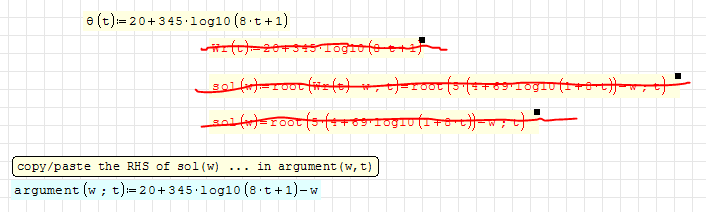

#57 Опубликовано: 01.11.2017 07:47:09
Cool stuff. The "discrete solver/inverser" takes approx 12 seconds to solve on my computer. None of the graphs start out at 20degC though, why is that?
Edit: Stupid question; what is the purpose of the "root" expression in your workbook? Couldn't the original theta.g expression be used in the solver instead?
1. Copy/paste the last collapsed area in new sheet.
Both methods start plotting @ 20 °C as specified from "if/otherwise".
2. Often, "maple/solve" returns the inverse function.
This one though it looks simple does not, alternately "root" does.
and by same token result is the simplified expansion.
This refreshed version looks like nearly the "last brick in the wall".
Please: don't hesitate for more questions ... Jean
ODE Multiconditional [Steel fire].sm (64 КиБ) скачан 69 раз(а).

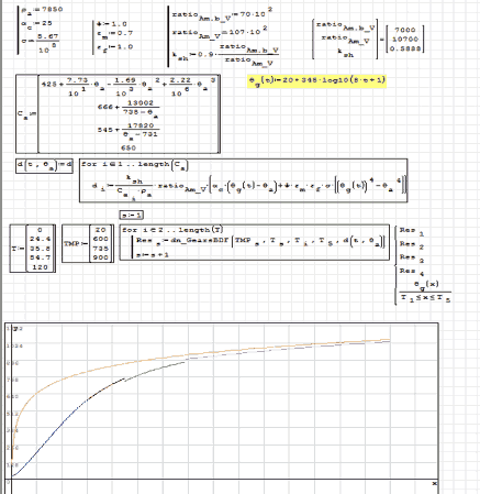

#58 Опубликовано: 02.11.2017 06:42:52
This project has been re-organised a bit for publishing.
Few things are missing: an abstract, identify the X,Y plot arguments.
The discrete solver/collector can be set incremental for finer tabulation.
ODE Multiconditional [Steel fire] Copy.sm (67 КиБ) скачан 69 раз(а).
#59 Опубликовано: 02.11.2017 17:41:43
hanskl
hanskl
I have organized my worksheet somewhat now, and collected only the relevant parts for my specific problem at the top. The other stuff that although it displays the power of SMath - it's not relevant for this workbook, is gathered at the bottom.

#60 Опубликовано: 02.11.2017 23:26:54
Something mysterious, it does not download *.sm, only some sort of "Chrome" document.
Nothing to see, that's OK unless I can help more.
Cheers, Jean
