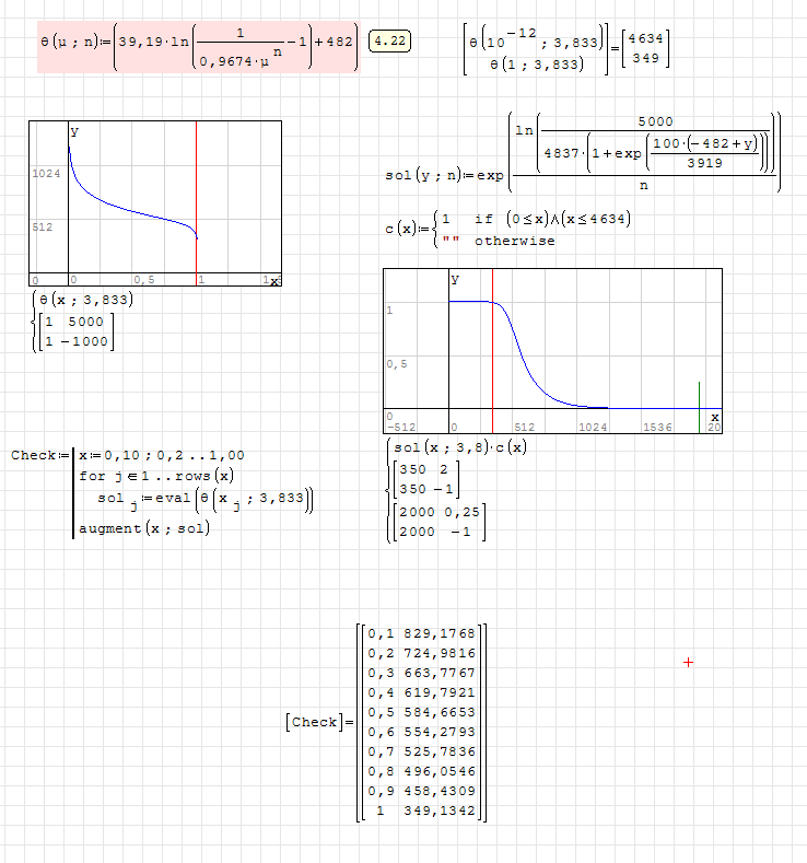

It is simply a matter of symbolically reversing a equation with respect to a variable.
Part of the answer in red [attached]
Will be back later on. Inversing a function
is sometimes difficult, but always possible.
Cheers, Jean4.2.5 Steel temperature development.sm (25 КиБ) скачан 75 раз(а).

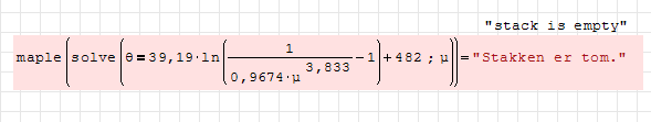

Thank you for helping me.
I just added the Maple plugin. It now tells me the input format is not valid...

#26 Опубликовано: 26.10.2017 18:25:00
This is the result I get.. I don't understand..
Ah ! Your attempt is incorrect, why ?
Power function X^Y is devil to maths. It involves ln(x) & exp(x),
Thus too reflexive for any symbolic solver, you must generalize.
See attached all, correct now.
Cheers, Jean
4.2.5 Steel temperature development.sm (41 КиБ) скачан 63 раз(а).

#28 Опубликовано: 26.10.2017 18:52:22
hanskl
hanskl
7 сообщений из 158 понравились пользователям.
Cheers, Jean
I'm sorry, but I really don't understand your approach to solving the equation 4.22 for my.0. But the results in the Check-matrix are indeed correct. Can you please explain what you did there?
Thanks

#30 Опубликовано: 26.10.2017 23:23:15
By inspection, if μ is < 1, we know in advance the result will be complex.
The "check" was to confirm this assumption. When you say solve for μ,
you are correct in your own words. In fact the matter is to inverse the roles.
From the explicit f(x):= ... where 'x' is given on range, now you want the
inverse of the procedure, i.e: given f(x) solve for 'x'. The procedure is
called "inversing". The Maple solution is the InverseFunction.
On that, Smath/Maple companions are far superior to Mathcad 11/Maple.
Please, read more on the revisited work sheet.
I will look at Radovan.
Cheers, Jean
4.2.5 Steel temperature development.sm (38 КиБ) скачан 63 раз(а).

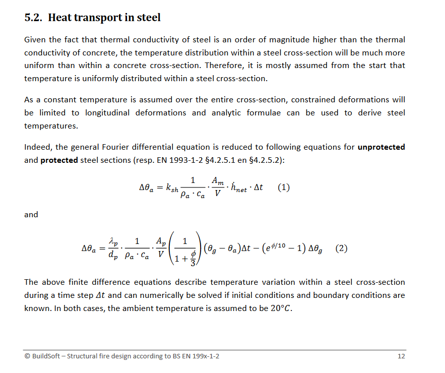

#36 Опубликовано: 27.10.2017 05:56:24
hanskl
hanskl
Try this one with another solver - dn_GearsBDF (it will escape from the critical regions - possible division by zero). Actually, it will work for all the four c.a() but not if you put them in the condition statement.
425specificheat-2-corr.sm (738 КиБ) скачан 61 раз(а).
Hi Radovan,
Forgive me my ignorance, but it still seems to me your result does not consider c.a as θ.a develops.
Is this completely impossible using SMath?
Best,
Your differential equation is dθ.a/dt = D(t,θ.a) = f(t,θ.a,c(θ.a)). Your goal is to find θ.a(t) by solving this initial problem in the range t[0,150] provided the initial condition θ.a(0)=20 finding θ.a(0+..150). I do not know how else to explain this to you, sorry.
P.S. The main problem here IMHO is why the solvers can not accept conditional statements for c(θ.a) taking into account the numerical nature of the solving this problem but, on the other hand, the individual c(θ.a) causes no problem.
I understand this part I think. It makes sense
What I don't understand is whether or not SMath is able to solve this. If it is able to do so, how do you formulate/structure the equation/solution?
If SMath is not able to solve this, what other approaches is viable to solve this problem?
I am sure this is a rather common problem in the world of chemistry and chemical engineering?
Best regards,
Edit: found a pdf which have tabulated θ.a(t) for different values of k.sh*A.m/V (=0.9V/A.m,b)
Page 7-10
tables for theta.a
Edit2: found another pdf which discusses the differential equation. It is apparently a Fourier equation, if that helps matters any.
Page 12-16
Fourier equation

Do you think I am onto something here?
Edit: I have cleaned up the workbook a bit.
testing 4 ode v3.sm (30 КиБ) скачан 63 раз(а).
#39 Опубликовано: 27.10.2017 15:59:32
Well done ! just add some of the EuroCode equations number ...
Cheers, Jean
testing 4 ode [Gorgeous].sm (24 КиБ) скачан 72 раз(а).

#40 Опубликовано: 27.10.2017 16:52:29
hanskl
hanskl
Cheers, Jean
Thank you for your compliment!
This would not have been possible without the help from you and Radovan!
BTW, I think I uploaded a later version than the one you editen. My latest version is v3, which includes two expressions that returns temperature and time for any given point, across the 4 ODE's.
