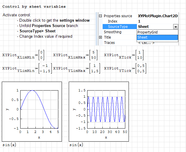

#2 Опубликовано: 13.12.2017 10:33:21
Is it possible to define XLimMax, XTick, etc on the canvas (outside of the Format dialogue box)?
I thought this was possible but I can't seem to get it to work.
Only Xmin, Xmax [quick]

#3 Опубликовано: 13.12.2017 18:39:36
Ryan Freund
Ryan Freund
19 сообщений из 339 понравились пользователям.
Thanks for the response Jean.
I believe I have worded my question poorly. In your example the "XTick" appears to be 250 and the YTick appears to be 1. This can be adjusted if I right click on the graph and go to format then adjust the "XTick" and "YTick". I am asking if it possible for me assign these variables on the canvas rather than having to go into the format dialogue box.
Hopefully this makes more sense?
#4 Опубликовано: 13.12.2017 19:16:29
1230 сообщений из 2155 понравились пользователям.
Section 2D plots XY Plot Plugin.sm (91 КиБ) скачан 107 раз(а).

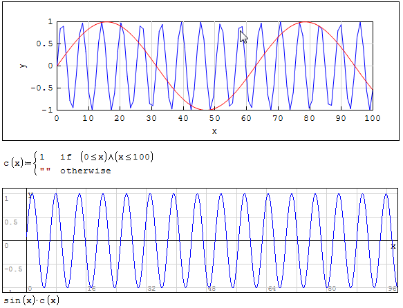

#5 Опубликовано: 13.12.2017 22:54:44
The Smath default quick plot plots values on canvas pixels
i.e: 96 PPI [Pixels Per Inch] ... this is for scalar plot wrt 'x'
X_Y does not understand plotting. To get the fine plot, you must
caliper in PPI the blank plot once stretched. From there, discretize
the ranged function on those number of pixels [scratching the left
ear with the right hand].
