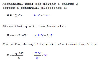

#10 Опубликовано: 01.02.2018 02:06:03
That's behavior isn't just maths doing something, but is concern about the the origins of the voltage laws, which, obviously, was mechanical (there are not multi meters at those times).
So, kg, m, s ... yes, that's natural that appear in mechanics, but electrons have their own mechanics too.
Working with units for those quantities is a big advantage for do the math in correct way.
