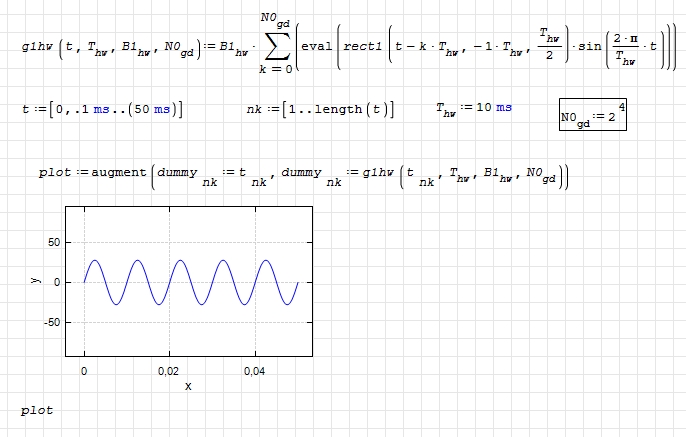

I recently came across a set of MathCad sheets, which I am attempting to extract a small sample; rectified waveform and ripple. As I am trying to reconstruct in SMath, early on, I cannot resolve a few definitions; functions "rect1(...)" and "g1hw(...).
I'm hoping someone can help. Attached is my SMath sheet and the reference MathCad15 files.

The function g1hw fails. The comment "k - not defined". Hopefully, the attached pdf of my fist page give you an idea. Pulses and Waveforms work in progress - nas.pdf (129 КиБ) скачан 83 раз(а).

Hi Norm. Some few notes:
- For speed up the code, you must to put at some places some eval() in SMath.
- Some vectorization are automatics in Mathcad, but not in SMath. Here you can use the index nk instead implicit or explicit vectorization, as shows the picture.
- N0.gc is 2^8, and it is for use as the finite index for fast Fourier sums, but it's too big for SMath. Use something lower.
- T.hw is undefined in you worksheet.
