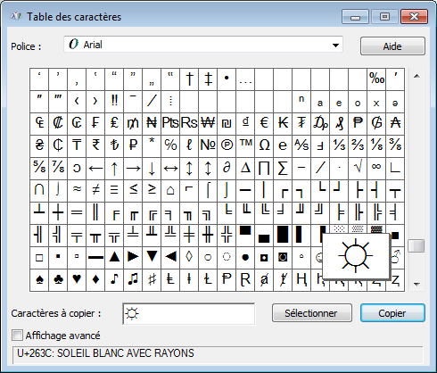

Hi IAks,
You don't need a plugin, just the right Unicode character (you can copy and paste the character from one site like Wikipedia, tamasoft.co.jp, alanwood.net or you can add the character holding the U and typing a #CODE# from the numpad)
look the attachments

#5 Опубликовано: 07.11.2018 08:51:32
I'm not sure why or how U+code was working in my previous Windows 7 OS...
I'm aware that paste doesn't work in variable typing (you can only select a whole variable and replace it); as workaround you have to build the variable in a text/writer region (or notepad) and paste it.
If you use writer region and you know the character code you can use CTRL+SHIFT+X (on hexadecimal code) / CTRL+SHIFT+D (on decimal code)
Without cnversion, in any text editor/region you have to wrap the uppercase code in slashes
All numbers are available as subscript/superscipt characters, although superscript 123 are in a different unicode block and might be rendered differently (uniode superscript/subscript ).
SO4\207B\\00B2\
¹²³⁴⁵⁶⁷⁸⁹⁰⁺⁻

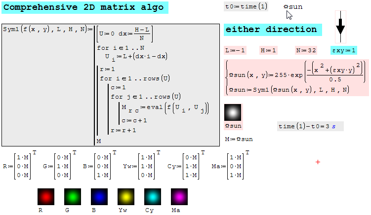

#10 Опубликовано: 07.11.2018 23:00:06
WroteIn astronomy I need to use a symbol that looks like a circle with a dot in the middle as a subscript
... from 6 years old .
Tentatively we can highlight a specific circular region.
The attached were left unfinished.
Image Planet Luminosity_1.sm (100 КиБ) скачан 56 раз(а).
Image Planet c(planet)planet.sm (79 КиБ) скачан 54 раз(а).
Image Planet fmap.sm (183 КиБ) скачан 52 раз(а).
Image Planet Luminosity.sm (219 КиБ) скачан 53 раз(а).
Image Planet Luminosity_2.sm (236 КиБ) скачан 54 раз(а).
Image Planet Gamma.sm (315 КиБ) скачан 57 раз(а).
