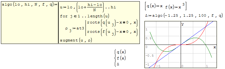

You can spline for in-situ calculation.
Solve Inverse [Seeded Scanner_roots].sm (16 КиБ) скачан 82 раз(а).

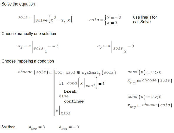

WroteHi. You can try this approach.
filter maxima solve solution - choose.sm (8 КиБ) скачан 96 раз(а).
Thanks! Very interesting use of the at() function, I didn't know it could be used with Boolean also. I not fully understand what the line() does to Solve(), but I tried without and and seen for myself that it will not work without.

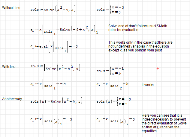

WroteI not fully understand what the line() does to Solve(), but I tried without and and seen for myself that it will not work without.
There was a post sent by Razonar why line() needed sometimes. I will try to find it.
the line is local definition.
sols:=]for the double vertical ▄
back space on the 2nd one
in the active ▄ solve(x^2-9,x)
More down the document is of local definition style.
... the function at(3) is used as differential operator.
Wrote... I not fully understand what the line() does to Solve(), but I tried without and and seen for myself that it will not work without.
Hi. line( ) does the same as defining sols (u) = Solve (eq, u)
filter maxima solve solution - line.sm (11 КиБ) скачан 82 раз(а).
