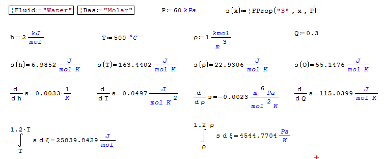

Oh, thanks. I want to use coolprop and smath to show the basic thermodynamics equations, like
the dT dS relationships, etc. With nice notation (even have not partial derivatives) and, of course, units.
Any way. Another question ... there are a standard way to plot with log scale? I can try to write my own function, but first want to know that. In the attached, a classical problem solved in less than two sheets, with the help of SMath.

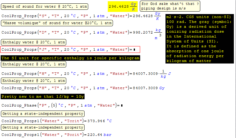

Physical water has two measurable properties [T,P].
Boiling drum operates @ saturation thus, measuring one gives the other one.
Here, it seems you are working compressed water [single phase].
It has 15 WASP properties ... how you call either one @ mystic from CoolProp.
Maybe, I don't understand the project.
Maths CoolProp_Props Copy.sm (403 КиБ) скачан 122 раз(а).

No comment ... just learn that fluid speed in piping
is no more m/s since century, rather Gy/K ... does is
run faster/slower/fly out of pipe/spits out $$$

Here what can I do, but guess that not much more, at least without an equivalent of wolfram's Hold or maple's x::uneval. I don't see any other way for handle the case with 2 variables, i.e. h(s,v), u(T,P) etc and have a true readable implementation of classic thermodynamics.
CoolPropDiff.sm (38 КиБ) скачан 121 раз(а).
Hi Jean. Good to read you. The "project" is just write the classical thermodynamics formulas and check them numerically, like

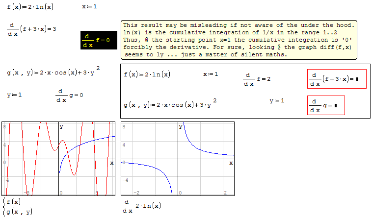

#10 Опубликовано: 29.01.2018 16:07:28
These two turned red in 6179, quite puzzling.
Are they red in your 6484 ? if YES => Oh !
