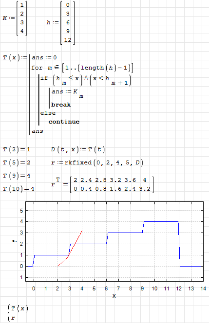

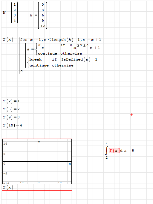

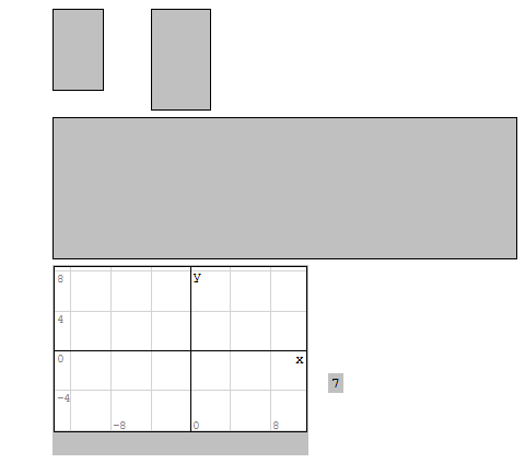

I'm trying to write a function that I can use to calculate the surface area. The function is to be based on data from a matrix with n elements
I ran out of ideas. I guess the problem is in a loop.
I attach a file and an image.
I will be grateful for your help.
Integral.sm (7 КиБ) скачан 56 раз(а).

You can define piecewise function this way. Haven't figured out integration yet. Built in int() function doesn't seem to work.

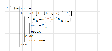

You can try something like this

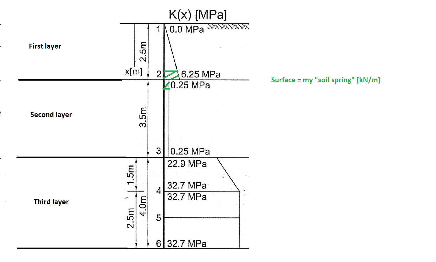

Thank you guys for your answers,
I will try to explain what I need.
Depending on the soil layers, I have a graph similar to the picture. At a later stage, I want to divide this chart into equal pieces (for example 0.25 m or 0.5m) to obtain "soil springs".
To simplify the example, I assumed that the elements of the K matrix are constant.
OK ... from there, apply your skill to produce the Cartesian graph
of the piecewise soil. No problem to integrate.
Integration of discontinuous functions is deceiving.

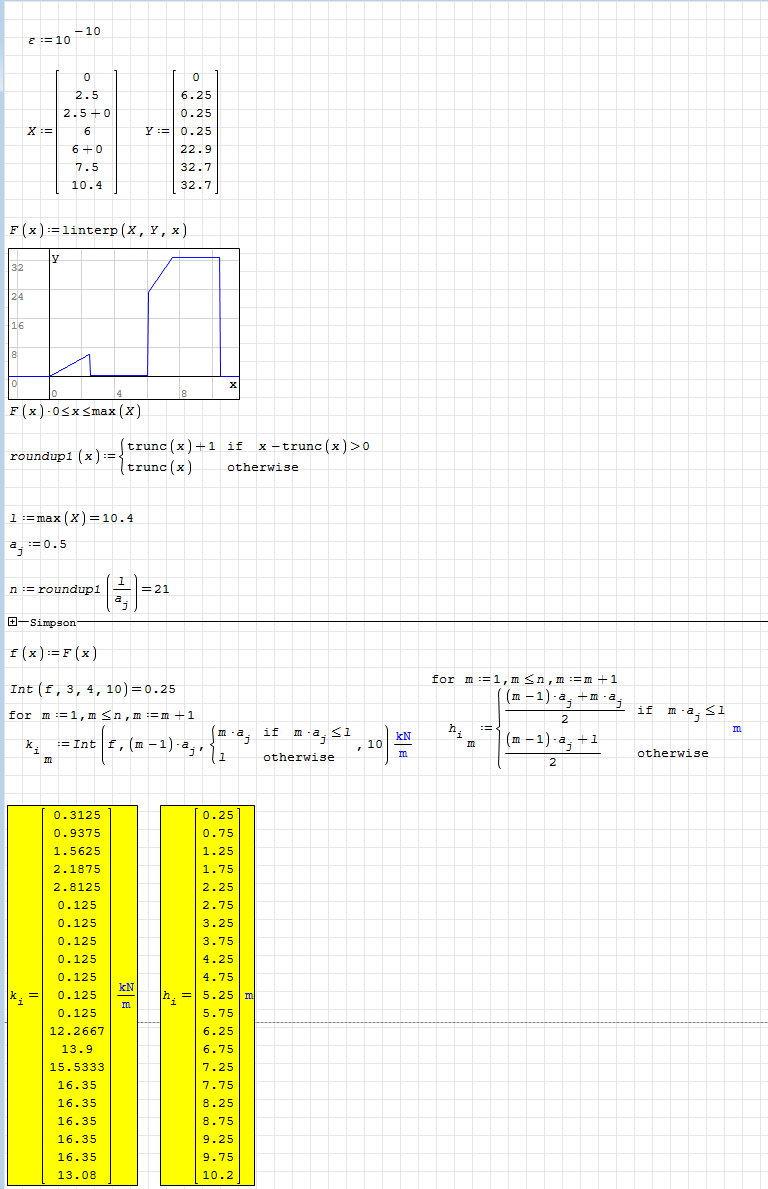

Thank you very much,
(btw the "thank" button on this page does not work)
The idea of ​​using linterp is actually much better instead of a loop.
Below is the file with the result I needed.
Final springs.sm (20 КиБ) скачан 53 раз(а).
The idea of using linterp is actually much better instead of a loop.
The "Tanks" button used to work years ago, not any more.
Good work ... two comments:
1. subscript is confusing with sub-sub index.
Very many projects are sub-sub indexed.
Reserve subscript as tutorial [exemplified].
2. variable name confusing with number is another killer.
you had 1:=max(X).
SS7030 was reputed good version, compatible SS 6179.
Final springs_1.sm (24 КиБ) скачан 61 раз(а).

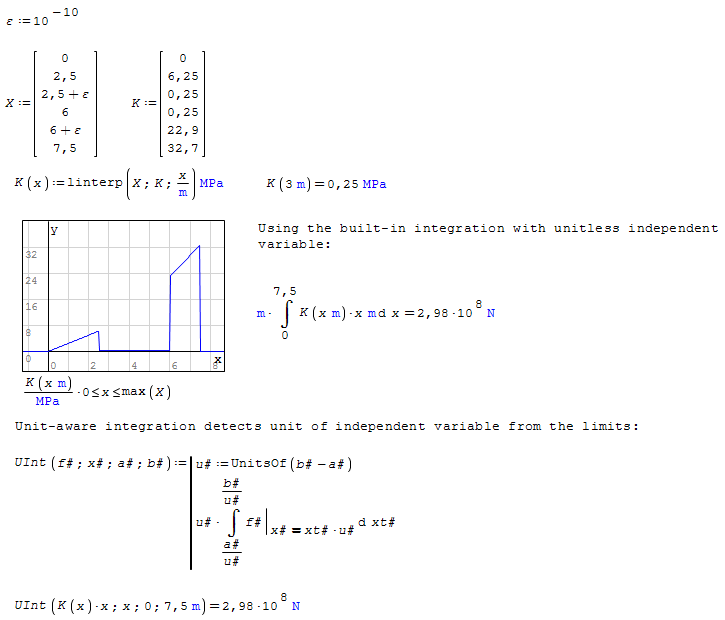

#17 Опубликовано: 22.09.2019 15:32:32
you can sub-space [at will]
... directly from the sampled data.
Subspace is a great utility.
Soil Simplifed from Sampled Data.sm (18 КиБ) скачан 66 раз(а).
