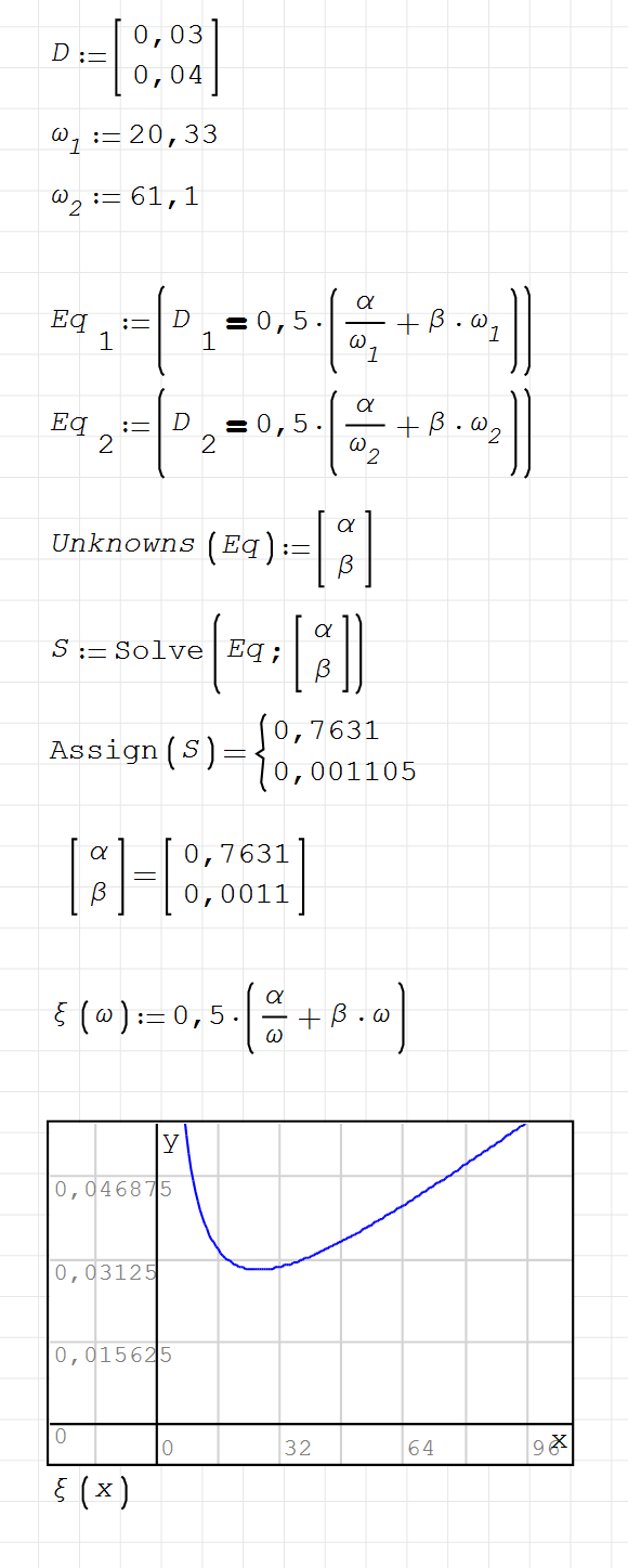

hi,
I used the Solve function a lot before but for some reason it does not work for this simple example.
I need to get the RayLeigh Damping factors alpha and beta using two frequencies, so two simple simultaneous equations should do it. tried using Solve but no luck.
Does anyone know why it is not solving?
Thanks in advance

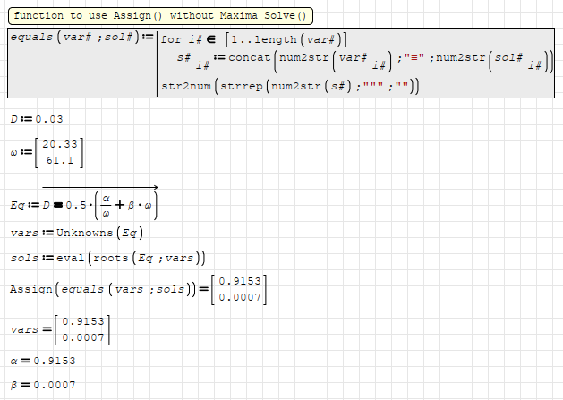

You can use roots() for your function. And a vectorize() can simplify it.
However, to use Assign() you will need this function to merge vars and solutions.
Assign_without_Maxima Solve().sm (7 КиБ) скачан 79 раз(а).

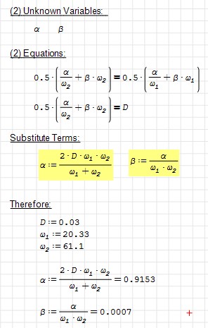

Greetings,
Another approach would be to use some elbow grease, you can substitute terms by hand and solve for 𝛼 and 𝛽:
Keypress (You can copy/paste the following into your worksheet):
α:{2*D*ω.1*ω.2}/{ω.1+ω.2}
β:α/{ω.1*ω.2}
*NOTE: ω.1 and ω.2 shown above are variables with subscript, they are not vectors ω[1 and ω[2; You should be able to substitute ω.1 for ω[1 if that serves your purposes.
- Kenny Lemens, P.E.

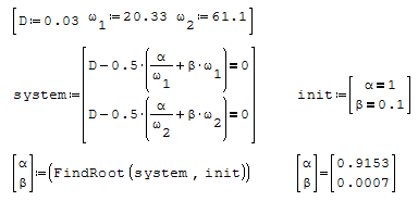

... more in there from native Smath code.
Solve FindRoot FORUM.sm (10 КиБ) скачан 77 раз(а).

And finally a version with Solve() and list injection region:
mathblock_Solve.sm (4 КиБ) скачан 76 раз(а).

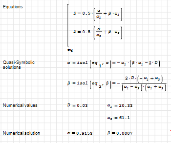

Hi. The isol solution, using only the Mathcad block plugin.
isol_example.sm (68 КиБ) скачан 87 раз(а).
isol_example.pdf (34 КиБ) скачан 67 раз(а).
