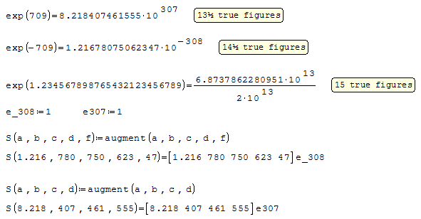

#5 Опубликовано: 15.04.2020 17:17:46
It's also a very good enhancement to help the "finishing" of documents.
Not so much use, whereas no CAS displays/accesses > 15 figures
Utilities Round(U,n).sm (13 КиБ) скачан 46 раз(а).
