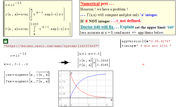

#1 Опубликовано: 10.10.2018 14:17:13
γ(a,x), Γ(a,x) ... read the document...
... mostly used in fitting data sets.
Γ(x) 15 Decimals [Abramowitz & Stegun].
Maths Special Gamma(a,x) Incomplete Quick Copy.sm (67 КиБ) скачан 64 раз(а).
#2 Опубликовано: 11.10.2018 13:45:41
Hello Jean
A few small changes in the part that is shown.
Maths Special Gamma(a,x)_Quick Copy_R1.sm (71 КиБ) скачан 62 раз(а).
Carlos
Carlos

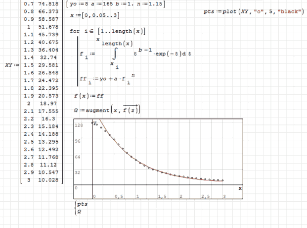

#3 Опубликовано: 12.10.2018 13:49:40
Playing a little test and error with the
coefficient y0, a, b, and n,
you get a better fit in the curve.
Maths Special Gamma(a,x)_Quick Copy_R2.sm (68 КиБ) скачан 57 раз(а).
Carlos
Carlos
#4 Опубликовано: 13.10.2018 16:24:36
WrotePlaying a little test and error with the
Thanks Carlos.
Here is an even better fit from your data reduction method.
Data reduction was introduced in the Mathcad DAEP [2003].
Kiby2 is stricking of realism ... attached.
More was done: linearisation of T/C [Thermocouple]
Genfit 000Carlos.sm (42 КиБ) скачан 71 раз(а).
Genfit Kirby_2 [Reduced].sm (75 КиБ) скачан 59 раз(а).
