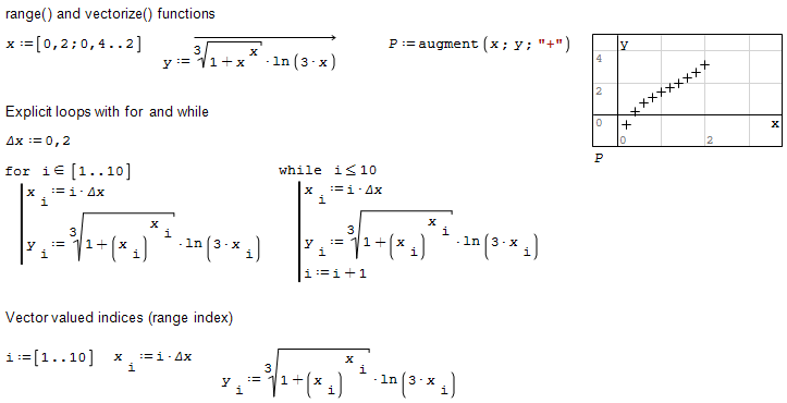

#7 Опубликовано: 14.03.2020 06:06:47
1222 сообщений из 2150 понравились пользователям.
You can do the job using a while loop but it is just one option (perhaps not the most straightforward one).
loops.sm (10 КиБ) скачан 60 раз(а).

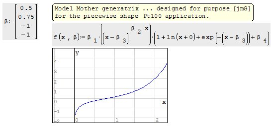

#12 Опубликовано: 14.03.2020 10:11:42
Pascal is pretty retarded these days for Engineering applications !
Years ago, Mathcad for Universities was pretty freaked.
Better use Smath productive for studies & Engineering.
Golden ratio will be a life time productive Companion.
As well as an advanced WhileLoop.
Golden Ratio jmG.sm (39 КиБ) скачан 58 раз(а).

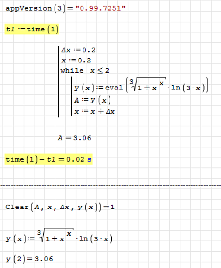

#13 Опубликовано: 14.03.2020 11:20:50
1417 сообщений из 2873 понравились пользователям.
so is it possible to check this function with while loop, or no?
Absolutely, and there are several ways.
If you need a step-by step feedback on the fly you can use breakpoints (menu of math regions) and the debugger window ("View" menu). You might have to store the intermediate results in a dedicated variable though, to don't look into the whole matrix at each step.
Also you can use the function trace() and the output window, or you can build math strings using concat() and other functions, or maybe something more complex using the script region plugin by uni.
loops-1.sm (30 КиБ) скачан 61 раз(а).
