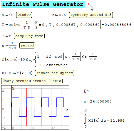

More in the attached Smath document.

If it works as delivered, just need to explore for more specific use.
"... reverse Engineer..." what ?
"... to decode ..." what?
Augmented version.
Maths Pulse [Square].sm (42 КиБ) скачан 88 раз(а).
