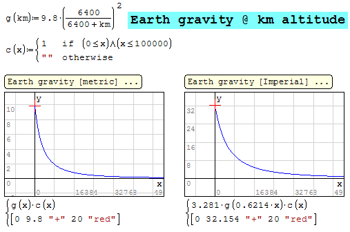

It is by default in Imperial units and I would like it displayed in Metric Units.
1. Disretize your Imperial,
2. Convert the X's in metric,
3. Convert the Y's in metric,
4. Re-tabulate/augment/plot
... you can convert both directions globally
Cheers
#7 Опубликовано: 16.07.2019 18:04:20
Maybe that's just what you want ... in vice versa system

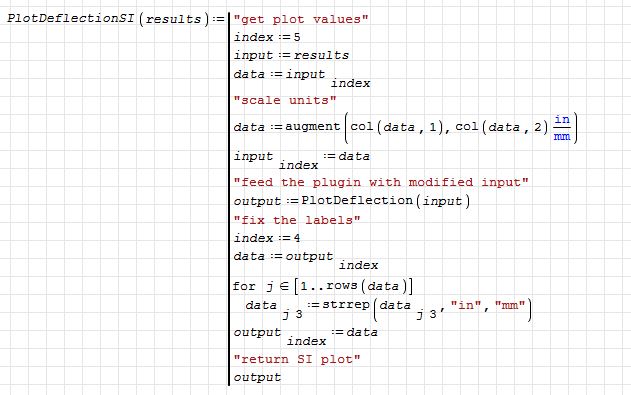

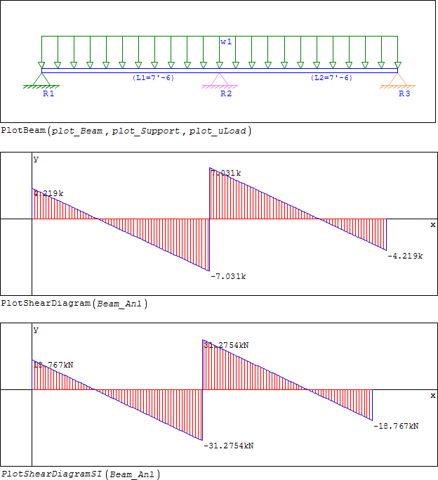

#14 Опубликовано: 19.07.2019 07:27:42
1417 сообщений из 2873 понравились пользователям.
Either
  1. Scale the input values
  2. Process FEA results using the plugin
  3. Fix the labels
or
  1. Process FEA results using the plugin
  2. Scale the output values
  3. Fix the labels
PlotShearDiagramSI.sm (5 КиБ) скачан 150 раз(а).

#15 Опубликовано: 10.08.2019 08:44:11
ianlh
ianlh
0 сообщений из 38 понравились пользователям.
Looking at this in more detail, I am trying to get the deflection plot to be in SI units, I can get the in -> mm. The problem is the distance to the point of deflection, I cant get it to go from ft-in to m. what do I need to add to make this work?
