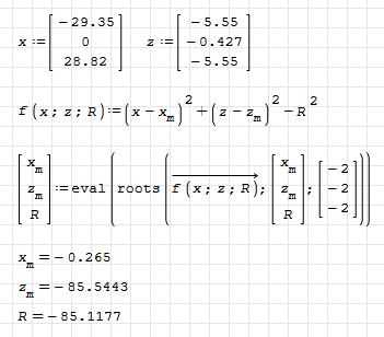

Im trying convert this mathcad solver to smath but it doesnt work.
Radius_318a.sm (9 КиБ) скачан 71 раз(а).

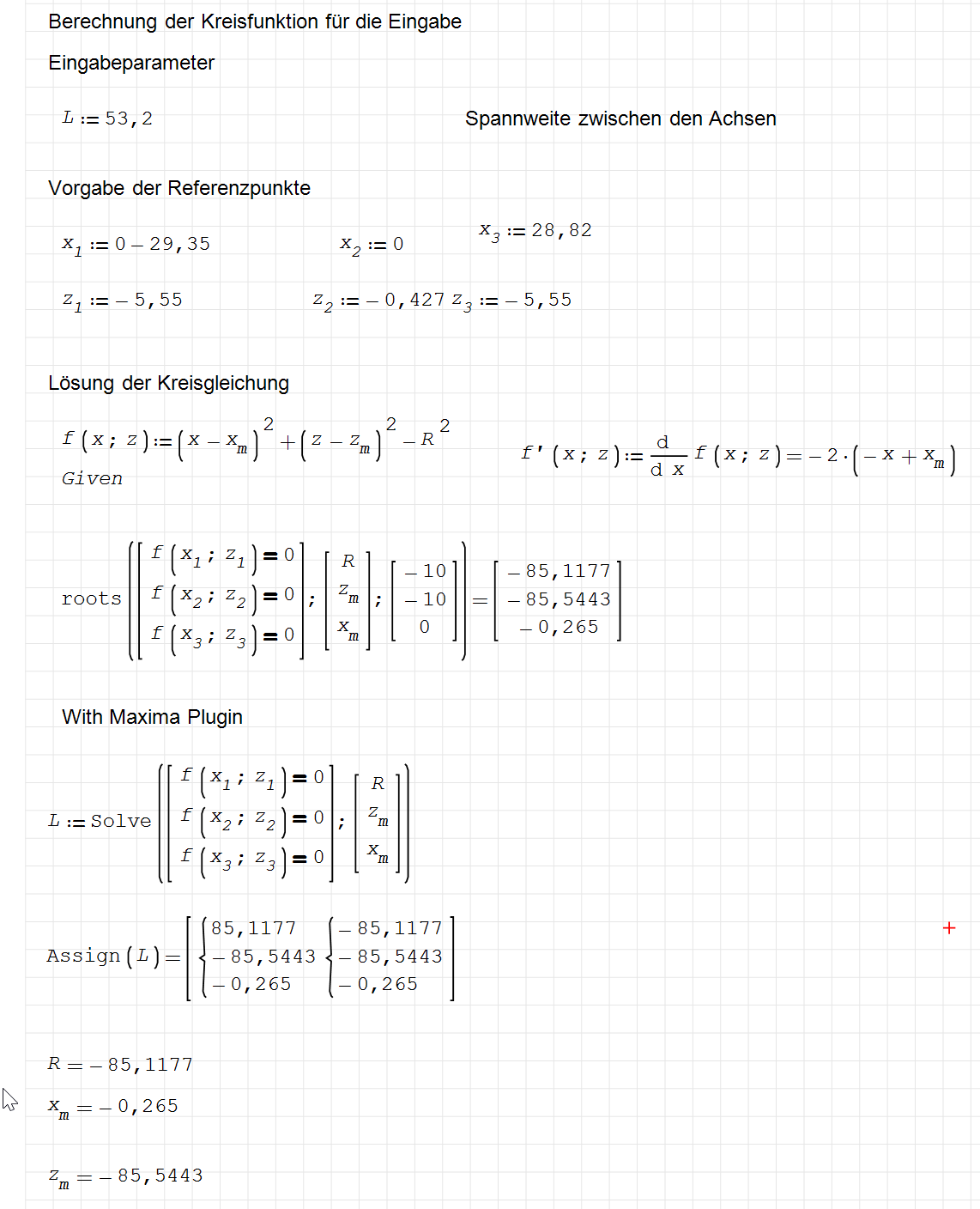

It is a non-linear system. With the internal "Roots" solver it is appropriate to use initial values sufficiently close to the result.
You can use some of the smath plugins that are more robust. For example, with "Solve" of the "Maxima plugin you get the result.
Radius_318a_ser.sm (337 КиБ) скачан 95 раз(а).

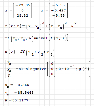

#3 Опубликовано: 21.01.2022 17:30:18
