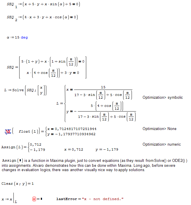

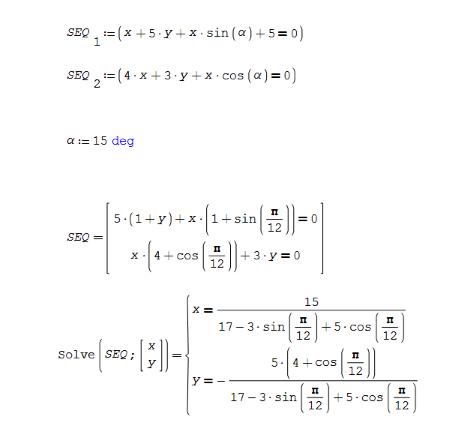

How to turn of the decimal values in trygonometry angles value? I got sth lik this for solution of system of equations:

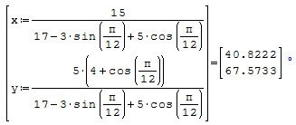

You can use the function al_nlegsolve with any initial
assumptions (because the equations are linear)

How to turn of the decimal values in trigonometry angles value ?
By default, trig are in decimal radian in all CAS.
Recast your solutions, fill-in the unit place holder.

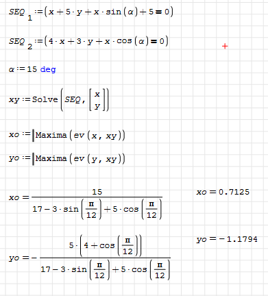

Hi. You also can use Maxima commands, in this case ev():

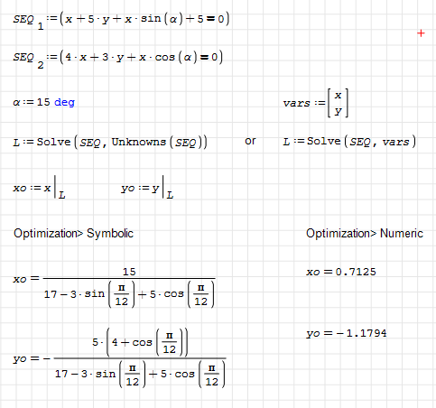

1230 сообщений из 2155 понравились пользователям.
example_v1.sm (13 КиБ) скачан 69 раз(а).
sergio 10.09.2021 06:11:00

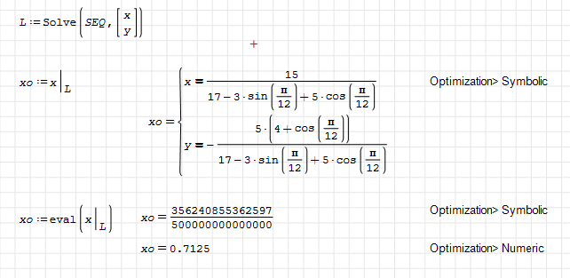

Hi Martin. I use Maxima's ev() because SMath's Assign() only works with the variable names, instead others, like xo, yo, and SMath's at() doesn't works for the symbolic evaluation, as shown this picture:
example_v1.sm (15 КиБ) скачан 65 раз(а).
This is a workaround for use only SMath native functions or plugins, without any explicit Maxima function:
example_v2.sm (15 КиБ) скачан 69 раз(а).
