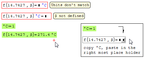

#8 Опубликовано: 28.09.2019 19:17:24
Hello, I would like to consult you
I define a temperature in degrees Centigrade, when I call it it looks like Kelvin degrees and then I can't make a sum because it tells me they are two different units. How can I do so that the defined temperature is maintained in every calculation in the unit that defined it?
Attached image capture of the problem.
Thank you
Thank you
#9 Опубликовано: 29.09.2019 04:22:37
There are many posts on the Forum about handling tempereture units. See for example this one.
