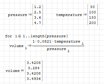

Could you tell me if their is any way to loop through a list the Way mathcad does with the I:=0..n, as a "global" methode (not inside a formula).
Below a screenshot of the case
Image explicative

Thanks for your reply.
I think i need to be more specific with my question.
I will make an exemple extracted from the internet (page 16)
link to the PDF
As you can see the loop is done for the whole spreadsheet, and it makes calculation notes a lot clearer.

Here you have:
The arrow over the math is the function vectorize(), and that's what you need to apply the elements of the ranges avoiding loops (that is the other way to accomplish the task)

Thanks a lot for the explanation!
You made my day!
