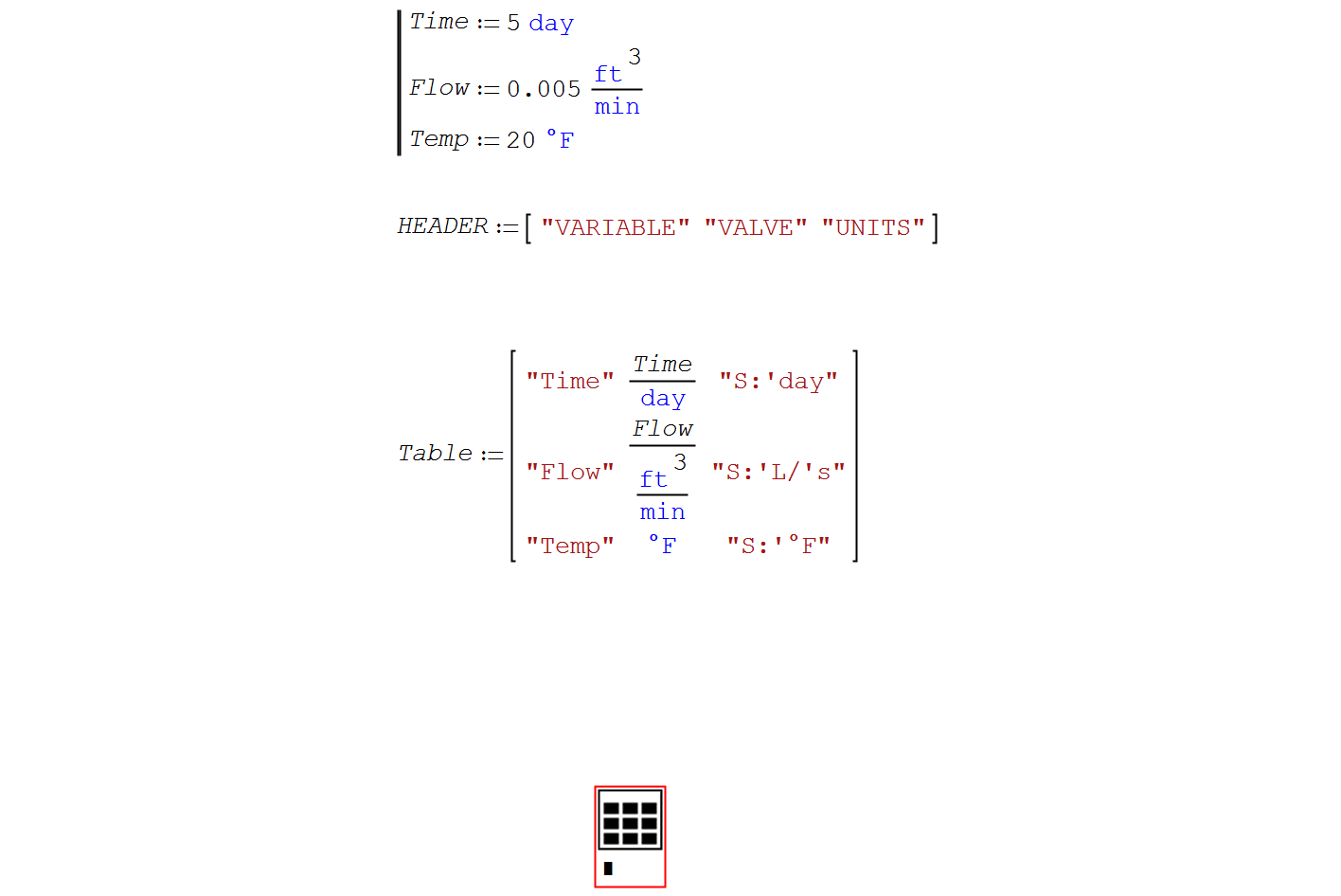

I just inserted a table region into my sheet, but I can't figure out how to change the number of rows or columns, or how to type in it. I select the boxes and a popup that I don't know what to do with pops up.

Once you have inserted the Table from the insert menu,
in that 3 x 3 chess board: type Table in the place holder.
Print Screen, paste in Paint, Select, paste in a tool
that will save as *.PNG [I use WinGrab for over 20 years]

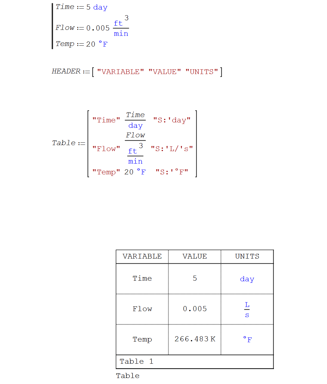

I defined the temp in degrees F, but it put it in degrees K

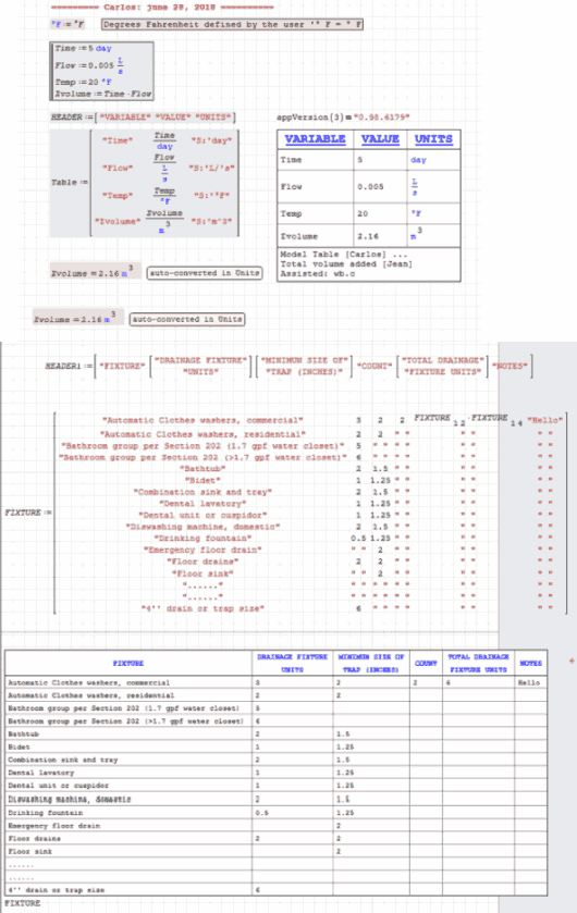

What I want to do is produce a table similar to the image I attached:
Hello
This is a part of your table
Table Region Carlos_R1.sm (28 КиБ) скачан 71 раз(а).
Carlos

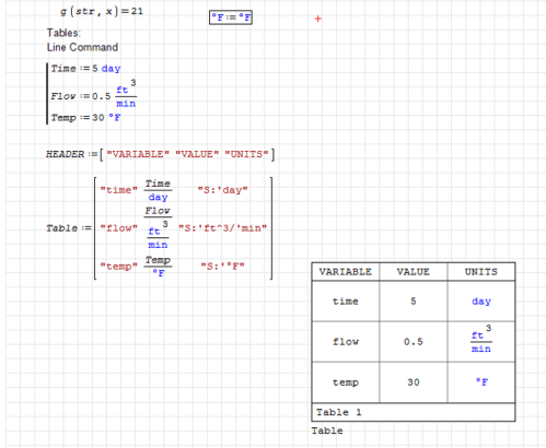

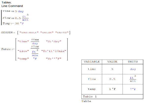

Seems to me that simply you are not using the Temp variable in your Table matrix.

Here is the correction. It was still necessary to define your own unit of
degrees farenheit to prevent Smath Studio from interpreting it as Kelvin degrees.
On the other hand in the table was missing include the variable Temperature
(temp) divided by the units (° F)
test _Britt1.sm (19 КиБ) скачан 58 раз(а).

I'd like it was completely arbitrary, I would have created some sort of artificial intelligence
Jokes aside, it is probably the value in the base unit (Kelvin).
I'm sorry but I'm from mobile right now, I can't check it deeply nor provide some example, I hope some of our skilled users can help you more here.
