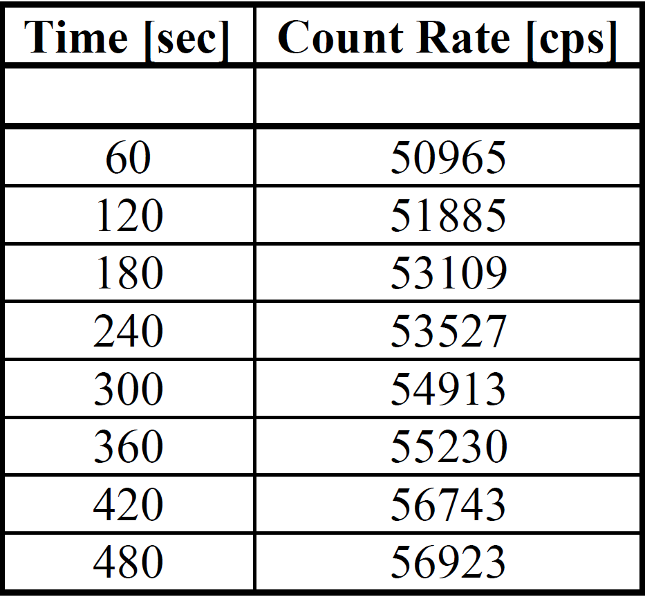

hi i have a table of values [R(t=60)=50965] with no obvious pattern and i need to create a function to fit into the formula
1/T = d (ln(R(t)) / dt
my thought was to make S(t)=ln(R(t)) and do d(S(t))/dt but i dont know how to turn a bunch of values into a function in smath and excel doesnt understand the function properly (i left out the last value and did auto complete and it was too far off)
R(t) is in counts per second
and i am solving for T

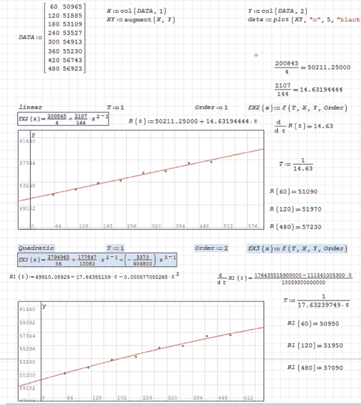

... in your original scale XY.
Data.sm (40 КиБ) скачан 52 раз(а).

1. You mean equation of the straight red line of the first plot ?
2. Or: the piece wise linterp between the support points ?
linterp, cinterp, ainterp are built-in Smath from f(x) menu.
The straight line in [1] can be manipulated a bit from statistical methods [Not Smath built-in].
Also, if you don't like the rough bifurcation at the supports
points, easy to fillet for smooth path.

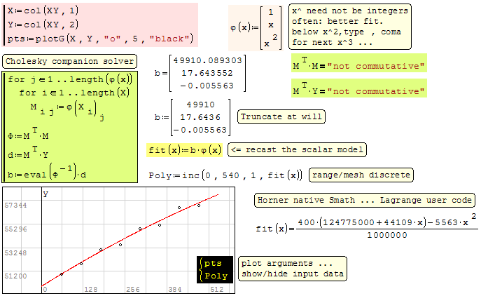

I think you can also use the least-squares method to find the equation that best fits your data.
Ajust_by_Last_Square_Selection_Engineering_studente.sm (62 КиБ) скачан 57 раз(а).

Here is Cholesky [Least Squares], otherwise.
Ge sensor [Germanium] is an exceptional application.
Genfit 0 Ge SubCryogenic.sm (39 КиБ) скачан 58 раз(а).
