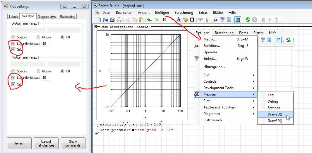

Actually, the Maxima plugin should work for the current stable SMath release. If there are any error messages, please let me know. The easiest way to get the plugin to work is to use the portable distribution (link in my signature). Then please follow the instructions in https://en.smath.info/forum/yaf_postst2078_Maxima-Plugin.aspx
There is a snippet "Draw Descriptions" to support the use of Maxima graphics commands (provides help texts in the dynamic assistant)

I want to plot log-log graphs.
So, the log-log plugin is not delivered with the latest stable version.
The logpts base/user is something most useful to populate the low region
of Engineering plot as well as pure maths.
Read 1rst "Demo", 2nd "Application"

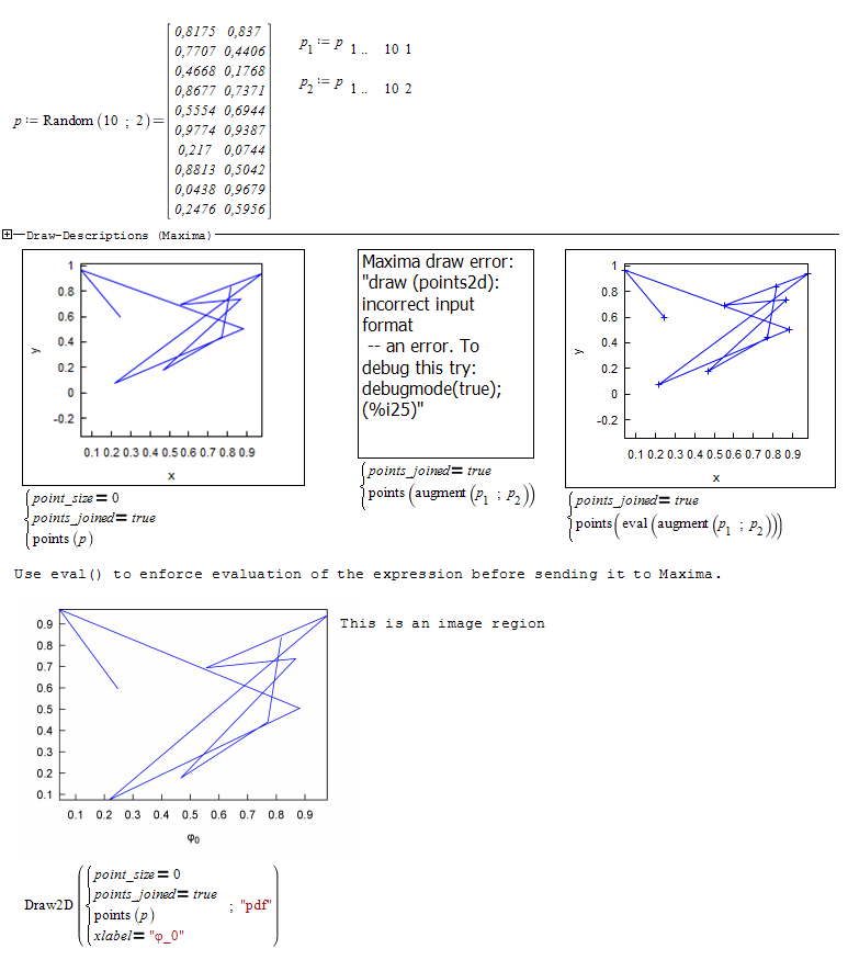

I am an SMath novice and not at all familiar with using Maxima, but I recently loaded the Maxima plugin to test out some of the graphing features.
I am trying to plot XY-scatter points that are saved in matrix-form. I can do this in the native SMath plot feature and the XY-Plot plugin, but can't seem to recreate this in the Maxima plugin...I get drawing errors.

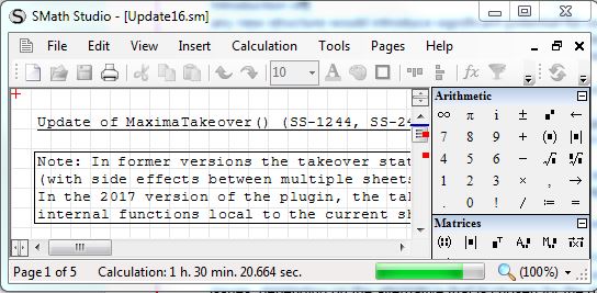

I tried dowloading an running the "Plugin%20Maxima%20Test.sm", but it was calculating for over 10 minutes and seemed to have some calculation failures in it. I am using SMath version 0.98 (build: 6484).
Can anyone see something that I am doing wrong? (PDF and JPG attached)
Thanks!

The maxima test has indeed some failures in it. If run the first time, compilation of Maxima packages can take a while, in particular for lapack, which usually fails due to insufficient memory allocation in Steel Bank Common Lisp. However, CLISP is slower and can't handle unicode.
points.sm (175 КиБ) скачан 94 раз(а).
points.pdf (204 КиБ) скачан 92 раз(а).

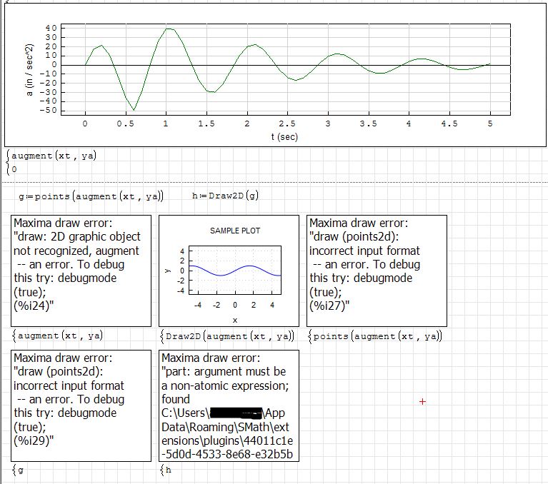

Thanks for the response.
However, the "Logarithmic" scale feature doesn't seem to be working.
With the "Logarithmic" box checked off, any changes made to the points equation (applying a 0.5 factor, for example) won't even be shown on the graph.
And I'm not sure if the logarithmic issue that I am having is related, but when I opened the "Update16.sm" file, it was still calculating after 90 minutes (stuck in a loop somewhere). This was the same sort of behavior that I was seeing with the previously noted test file.

SM attached (Maxima graphs are at the bottom)
HW5-2 - Copy.sm (67 КиБ) скачан 126 раз(а).
#13 Опубликовано: 09.11.2017 05:30:29
1230 сообщений из 2155 понравились пользователям.
The plotting function is not robust enough to silently suppress undefined values. In log-plots make sure that your points are strictly positive.
