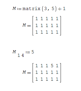

#3 Опубликовано: 28.09.2021 08:37:33
1417 сообщений из 2873 понравились пользователям.

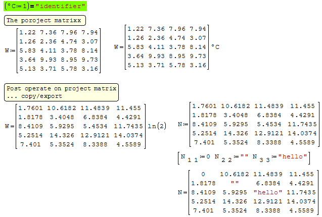

#4 Опубликовано: 28.09.2021 09:17:41
... observe the empty place holder is a / operator.

Thank You Jean, but rather, I meant to extract a specific element from the matrix. Sorry but my English is very poor.

#6 Опубликовано: 28.09.2021 11:15:31
There are many more ways ... like skinning a cat.
Cheers ... Jean.

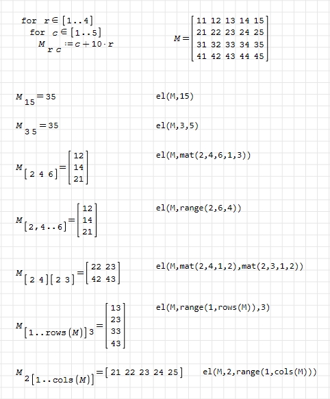

#8 Опубликовано: 28.09.2021 16:21:01
Alvaro Diaz Falconi
Alvaro Diaz Falconi
Hi. There are many different ways to access the elements of an array. This list is not exhaustive, and does not include the submatrix function.

Thank you so much, especially for the examples (Jean, Davide, Razonar). It brightened up a lot of problems for me regarding matrices. Once again, thank you very much. One more thing, how do you write the range of elements in an array? Regards Adam

#11 Опубликовано: 30.09.2021 13:37:31
Alvaro Diaz Falconi
Alvaro Diaz Falconi
... One more thing, how do you write the range of elements in an array? Regards Adam
Use vector element
or matrix element
and then put a range (with 2 or 3 arguments) in the index placeholder
