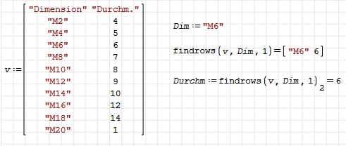

Hallo guys,
is there a similar function in smath for sverweis like in Mathcad or Excel?
Searching for a variable in a matrix and give back a certain number in that row?
Thank you br Stefan

Hi. You have findrows in SMath

o perfect thank you!!!!

You can either use findrows() as Razonar mentioned.
Or you can use custom written vlookup() function uploaded before.
But I would stick with findrows() if I had to choose.
