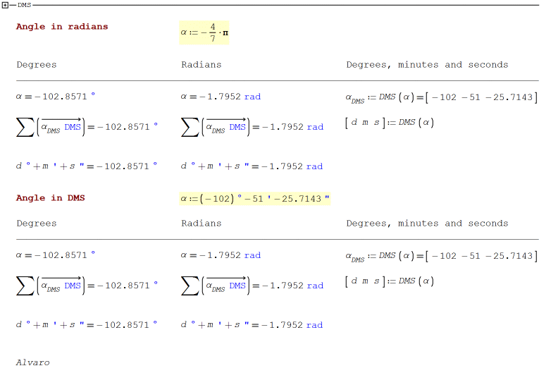

WroteHi. Here, my workaround.
DMS.sm (17 КиБ) скачан 70 раз(а).
Hmmm... The separate units use is interesting. I am so inexperienced with SMath I can't figure out how to enter the summation portion.
I think I will need to leave the negative angle input as [ -d -m -s ] with this approach. Would you agree?
WroteI am so inexperienced with SMath I can't figure out how to enter the summation portion.
Ah-ha! The vectorize function.
Hi. Try this as general rule for SMath sintaxis:
Guess yes:
