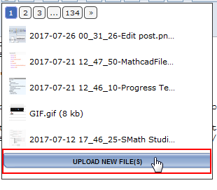

About the attachments, there's a button in the post editor, click it, then choose "upload new file(s)" and finally when you're done "start upload(s)"
