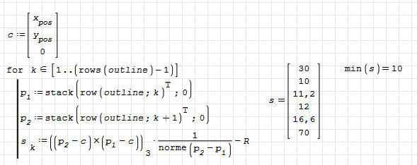

This provides the shortest distance from the segments of the polygon to the circle. However, the distance isn't really to the segment but to a line through the endpoints of the segment. There is no test if the normal to the line through c is between the vertices of the segment.
For the given geometry this works. For proof of strength this is only useful if a given force may act under any angle but the force doesn't depend on that angle.
Lug Horizontal_Kr.sm (31 КиБ) скачан 56 раз(а).

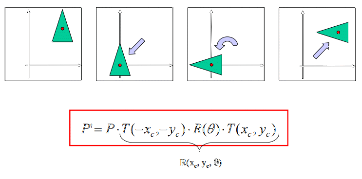

ianlh, in your example it’s convenient to use the rotation matrix
Lug Horizontal1.sm (18 КиБ) скачан 60 раз(а).
Hi. This is what's actually do the Ber'f function:
But notice that for use matrix multiplication for translations you must to use homogeneous coords ( http://elopez.fime.uanl.mx/@materias/732/@Tema%203%20-%20Transformaciones%202D.pdf page 15)

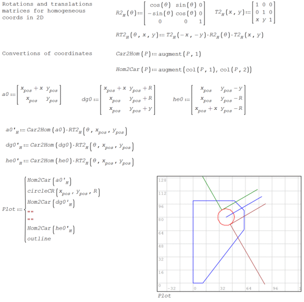

Thank you, Razonar.Aapplying homogeneous coordinates helps automate the process.
Variant with homogeneous coordinates
Lug Horizontal3.sm (17 КиБ) скачан 55 раз(а).

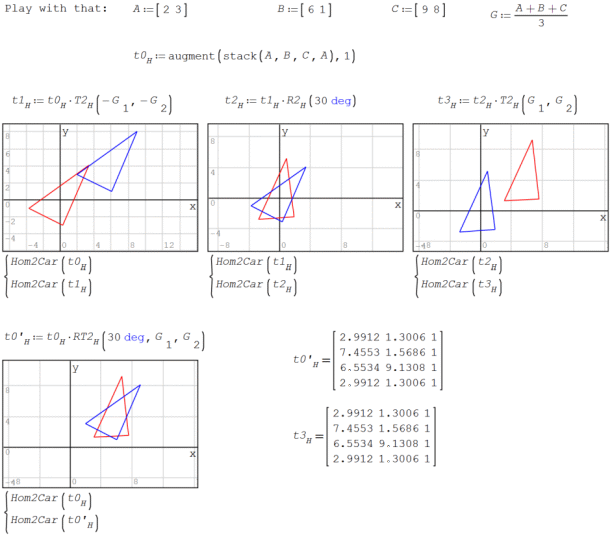

Variant with homogeneous coordinates ...
Another variant.
Lug Horizontal4.sm (34 КиБ) скачан 53 раз(а).

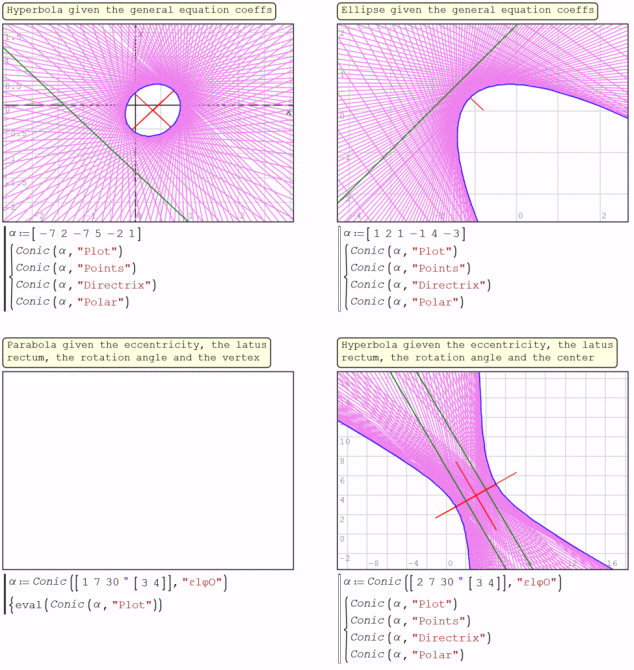

Homogeneous coordinates are helpful in projective geometry and conics and quadrics. For instance, preserve the duality, because you can use line coordinates ( https://en.wikipedia.org/wiki/Line_coordinates ).
I try to modify for use that in https://en.smath.com/forum/yaf_postst17357_Conics.aspx but can't found a close end. This is my atemp for the dual of a conic, it's envelope:

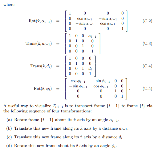

Hi Ber. That's not science, that's art. Maybe you can find this book interesting: Modern Robotics.
At page 608 in the pdf, for example:
The notation isn't the best, but it can be converted to a general Rotations and translations for the forward kinematics of a robot.
