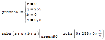

OK, one more try:
I wish to declare a color as green50 which is rgb green with 50% opacity.
green50:=(0,255,0,0.5)
and then use it (ie pass green50 as a variable) with Davide's rgba snippet:
rgba:=(green50)
Thanks in advance.
#16 Опубликовано: 20.11.2022 08:27:40
1230 сообщений из 2155 понравились пользователям.
OK, one more try:
rgba:=(green50)
Thanks in advance.
If you just want to store the input to rgba() in a separate variable and apply it later, then you might use the at() substitution function. Yet it is not clear to me, why one would do that instead of just storing the resulting color string from rgba()
Blatt5.sm (3 КиБ) скачан 87 раз(а).
Mark R Harris 20.11.2022 15:26:00
#17 Опубликовано: 20.11.2022 15:26:54
Mark R Harris
Mark R Harris
4 сообщений из 90 понравились пользователям.
Thank you Martin, excellent.
