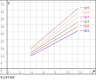

Can we plot, quickly, a function that uses two ranges ?
The 2nd plot is only the XY axes system, as r and t are just multiple.
Maybe, there is a missing link ?
Heat Capacity.sm (22 КиБ) скачан 67 раз(а).

Just opened Ber7 document and completed to export the multiple data sets.
You can tabulate as well p2, p3, ... p6 then make a unique export table.
The meshed pivot is an exceptional tool, save it.
Plot Otherwise SS6179.sm (35 КиБ) скачан 61 раз(а).

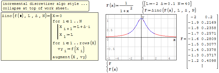

... super discretizer, algo style.

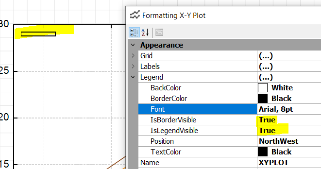

Really helpful. Is there a reason that a legend cannot be created on the plots (X-Y Plot) that are individual colors? I realize you used the built in graph and I updated my snippet sheet with the X-Y PlotCapture.PNG
NEVERMIND ... It'S under TRACES, not LEGEND

Ber7 did the 2 var collection in nested vector form,
my last version is table style, much more convivial as I'm used to do.
Units are just a pen in the ass[hole].
A good way is to work units-less, then append silent units.

Thank you guys. I should have just deleted the question when I figured out the legend issue in lieu of answering myself. As mentioned above, it was under TRACES, not LEGEND, in the X-Y Plot
