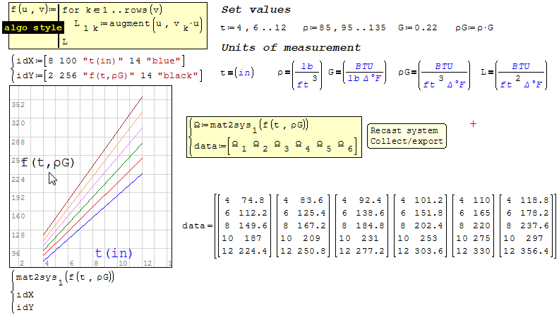

A good way is to work units-less, then append silent units.
Calculation without units. Units are presented at the end of the calculation
Heate.sm (9 КиБ) скачан 56 раз(а).

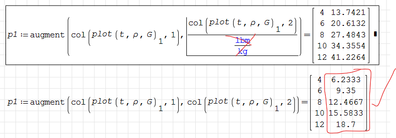

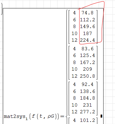

Still off by a factor of units (12 to convert inches to ft). I split this to a NEW TOPIC. I've never used the Mat2System function.

Thanks Ber7, nice sterilized units
Heate 6179.sm (14 КиБ) скачан 56 раз(а).

That's the problem. Units are important and impact the way the function is not working. Divide t by 12 and the The x column no longer starts with 4, but 1/3 and the y column is correct. Leave it as is and the x column is correct and the y column is wrong.

I love Ber7 method, saved it personal.
Easy to scale/reconciliate from your original by 'λ'
Unit Waterloo Otherwise.sm (15 КиБ) скачан 47 раз(а).

In dimension Ro there is a ft. Therefore, the size t
should be expressed in ft. The bug has been fixed.
Correct, divide by 12 ... in this case.
This elegant function appears to work on all empirical equations, as long as the user input units are double checks for consistent cancellation.
