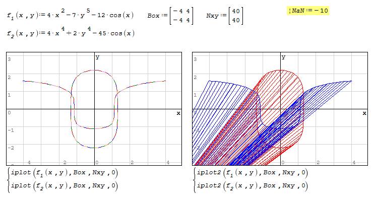

Hi. I'm trying to implement this implicit plot. But can't "cut" the lines in the xy plot. Also, any help about speeding the function is welcome.
iplotq.sm (40 КиБ) скачан 172 раз(а).

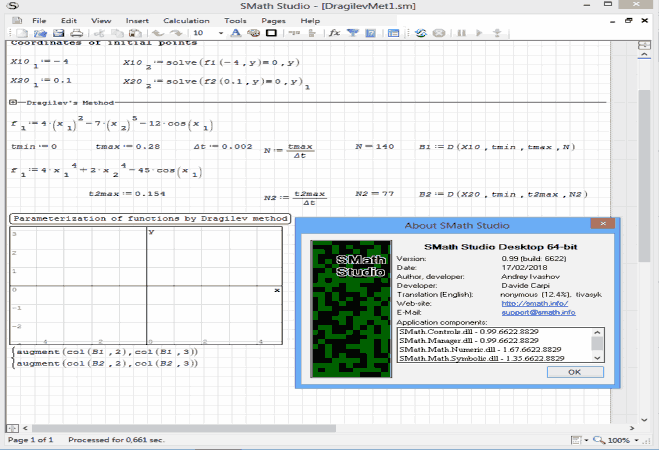

Hi Ber. Thanks for the implementation. But it use maple and is semisymbolic, I want just some that can works in the cloud, like: https://en.smath.info/cloud/sheet/s23Pa6bZUn
#4 Опубликовано: 19.02.2018 06:38:09
Fridel Selitsky
Fridel Selitsky
Option without Maple
DragilevMet1.sm (21 КиБ) скачан 104 раз(а).

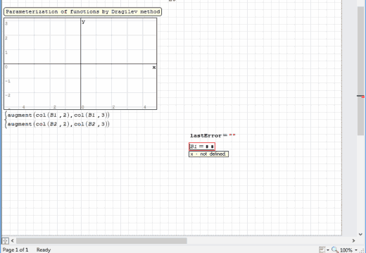

Not graphic
It does not show any error
Carlos
#7 Опубликовано: 19.02.2018 21:28:12
Alvaro Diaz Falconi
Alvaro Diaz Falconi
997 сообщений из 1676 понравились пользователям.
Hi Carlos
For see the error message type B1=
#8 Опубликовано: 19.02.2018 23:44:57
CBG
CBG
77 сообщений из 312 понравились пользователям.
Hello Alvaro:
Thank you very much.
The error in the graph is that x is not defined.
What causes this error?
In the graphs published by you it is seen that graphs correctly.
Carlos

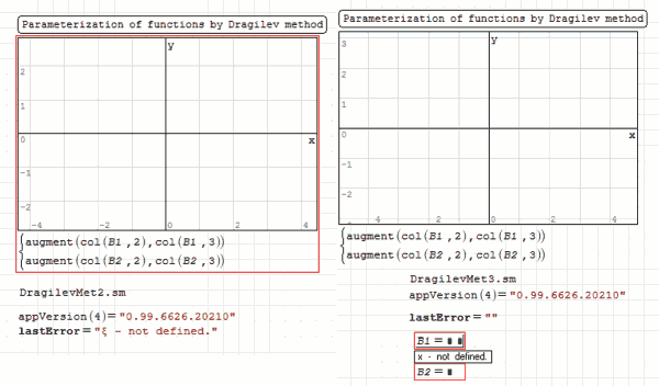

Hola Alvaro, Hello Ber7,
Thanks for your reply, but the DragilevMet2 and 3 files do not work.
The file of Ber 7 does not show any error, but by requiring the value
of B1 and B2, it says that "x" is not defined.
Attached drawing of the errors.
Hello Jean, your files worked perfectly.
Carlos

Hola Carlos.
It's because a problem with rkfixed routine in your environment. Try to download this, or use it in the cloud: DM_RK
#14 Опубликовано: 23.02.2018 15:56:57

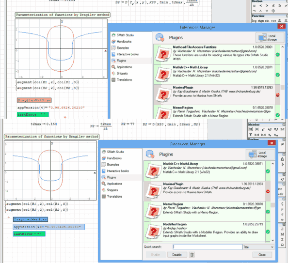

Hola Alvaro:
Gracias por tu respuesta.
Thanks for your answer, but I found the fault.
The interference is caused by the Maxima Plugin,
by disabling it, the file works correctly.
Carlos
#15 Опубликовано: 23.02.2018 23:30:39
CBG
CBG
Hola Alvaro
Here too, the problem is caused by the decimal separator "Point",
Changing in options, the decimal separator from "Point" to "Comma", (from "." To ",")
resolves the problem of graphing
Carlos
