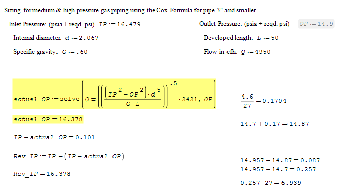

Your problem seems to be quite simple and mentioned here on the Forum many times (maybe to many...).
Using solve()
GASHP-cor.sm (9 КиБ) скачан 43 раз(а).

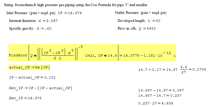

Using FindRoot() from Numerical Solvers plugin
GASHP-cor1.sm (10 КиБ) скачан 56 раз(а).
Using solve()
