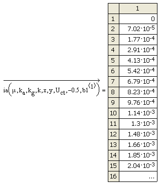

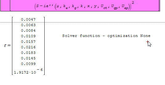

I did some corrections because you had some errors. Your f - "Solver function" was problematic and quite wrong. The vectorization did not work as you expected. Therefore I used for loop to overcome the problems - defined iaa() instead of ia() function (see for yourself, please). However, you will have rather huge number of equations to be minimized in order to find those seven variables. Mathcad will solve those things easely. Nevertheless, I mentioned many times that this kind of minimization problems (least squares for example) when you have rather complicates analytical expression is almost impossible to solve in SMath. Just for example, see the changed f - "Solver function". I made your problem with ten equations which have to be minimized. You can also made just one (by adding them, for example). But all these things will not be on any help. SMath is relaying on its symbolical symbolic engine - not numerical (I mentioned this many times).

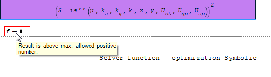

This is an example where symbolical engine will fail, and there might be no help for that. If you put the optimization of f to be symbolical, this will happen

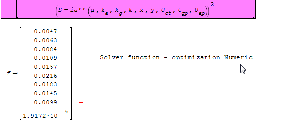

Symbolic engine failed and there is a great chance that you have to give up with this problem. If you get another optimization (Numerical, None) you will get some values
but this will not help either. The problem is just to complicated analytically, and there is a need for strictly numerical solvers, but there are not present in SMath yet and I am not sure if there would ever be any.
