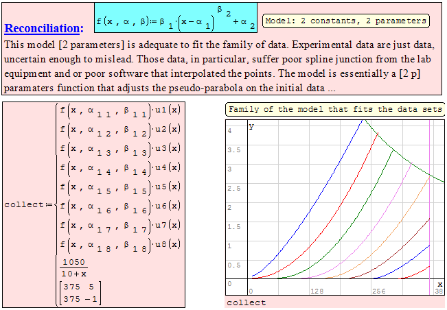

Each system has its own XFR ... one is exemplified in the attached,
from the data generated by Carlos from Norman simplified formulation.
To resume your concern:
1. get reliable data from your simulator
2. attach those data, we will try solving the XFR.
Project Tesla_CBG_R1 [optimized] Copy.sm (212 КиБ) скачан 60 раз(а).

... this model should solve all curves.
It solves/iterates nicely for this particular data set.
f(x,β) recovers from the reduced solving procedure.
Genfit Minimze Tesla.sm (45 КиБ) скачан 70 раз(а).

The attached proposal fits your data sets based on 2 parameters and 2 fixed constants.
The constants are the initials X, Y of each experiment. It needs only two parameters
for each experiment. The model function is not suitable for auto-iterate ... peanut
work to calculate trial/error.
If possible, it would be interesting your collect ~ 20 points, raw ... as measured
with good equipment. No processing, no spline curve junction.
Salut Nicolas, will read you soon ... Jean
Genfit Minimize Tesla(5) Copy.sm (207 КиБ) скачан 66 раз(а).

... easy to trick the argument (x+ε)
Now, with a single set of initial β it iterates
and fits all data sets !
Genfit Minimize Tesla(5) Auto_Iterate.sm (211 КиБ) скачан 65 раз(а).

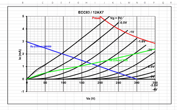

I found this page that I hope will be useful:
http://www.valvewizard.co.uk/links.html
It contains a file in excel for the calculation of the triodes graphs
LoadLinePlotter.xls (817 КиБ) скачан 63 раз(а).
