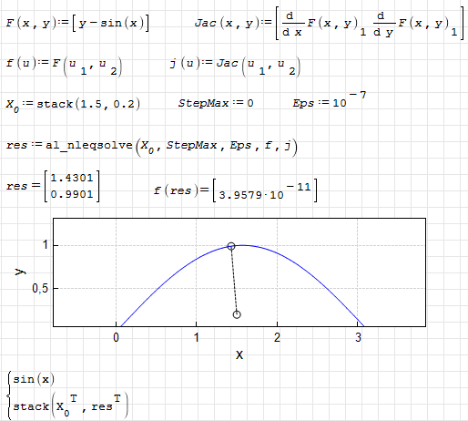

Underdetermined nonlinear system of equations.Three equations with four unknowns.
Visualization of finding the roots
Visual.sm (16 КиБ) скачан 76 раз(а).

ola_nicolas, I just slightly reduced the code of your program.
Nicolas.sm (12 КиБ) скачан 62 раз(а).

However, AlgLib Solver works faster and depends little on X0 matrix.See # 29
https://en.smath.info/forum/yaf_topics32_Extensions.aspx
Overdetermined.sm (15 КиБ) скачан 81 раз(а).
