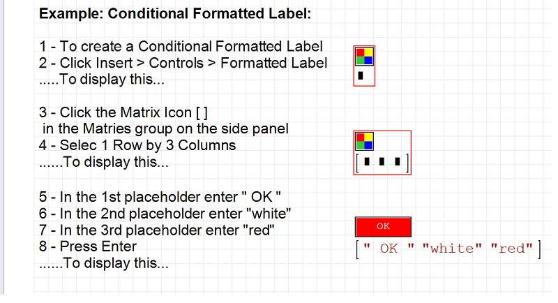

3 - I can't enter the square brackets at the beginning and end of the CFL defining... like...
[" OK " "white" "red"]
The CFL widget only lets me enter parentheses, not square brackets.
Is there a trick?

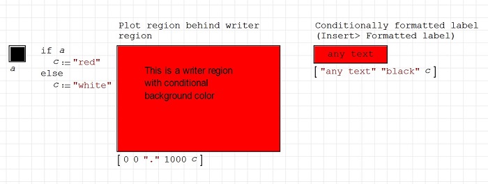

4: How can you enter math symbols like the summation or integral symbols or radical symbols?
a. In CFL?
b. In Writer Region?
5 - How to add a clickable button to change the color of a Writer Region or a CFL?
(someone shared Background.sm with me that has this example)

Is there a trick?
Use matrix, square brackets are matrix.

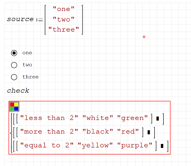

5 - How to add a clickable button?
There is Radio Buttons which can be used.
6 - To include a picture in the post?
Use attach symbol while entering posts.
Choose your picture file or suitable file.
Click to upload. It will be added to your post.
Check the example file for your questions.
CFL with radiobuttons.sm (4 КиБ) скачан 103 раз(а).

I don't know a way to change color of a Writer region with a button.
You can use CFL for this scenario. CFL's purpose is this actually.
Change its content, foreground and background colors with variables.
And you can use Radio Buttons to alter a variable.
And use that variable value in CFL's if() or cases().

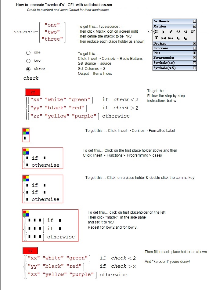

OK, Great! I understood most of the answers... I think :-)

From your answer I was able to create this... (and thanks to Jean for encouraging me to explore CFL)
CF_Label_Tutorial.sm (4 КиБ) скачан 98 раз(а).
You guys let me know if I got it right.

I still can not find out how to create a square area to make it a clickable button.
Do I need the "Control Region" Plug-in to make a clickable button or what?
There is no option/support/plugin/etc for a clickable button in SMath.
There are checkboxes, radio buttons for clickable situations.
What you want is a Button as in Excel visual basic macros.
We don't have that in SMath, yet.
And you can't use CFL to make it behave as a button.

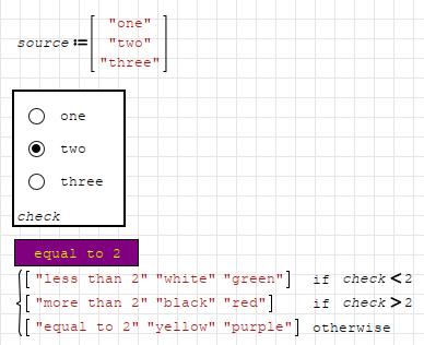

In overlord's post near the beginning of this thread he provided a sample...
CFL_with_radio_buttons.sm
I was trying to replicate it from scratch to see if I could do it...
- I created the 3 radio buttons...
- I created an "expression" with 3 placeholders vertically
- Then made a 1x2 matrix for each of those 3 placeholders
- Then made a 1x3 matrix for the first element in the 1x3 matrix
But it doesn't look the same as his... mine looks like this...
Question 1: How were the 3 lines in the CFL Created?
Question 2: How was the "if" statement created without an "else" ?
Also, when I downloaded and launched his example it told me he was using a newer SMath version
My SMath version is 0.99 (build 7822) Date 6/1/21. on Windows 10 Pro
Question 3: If there is a newer version/build would I install it on top of my existing version or first uninstall the current version of SMath?
Thanks for the help folks !
with cases() function.
With cases() function.
It is useful for multiple if situations.

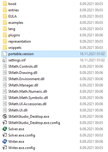

a - You don't need to install beta. You can set smath to act as portable.
All extensions, settings, etc will be kept in that directory.
Just download SMathStudioDesktop.0_99_7921.Mono.tar.gz or any other build.
Extract it to a directory. Create an empty file "portable.version"
That smath will be portable sitting along with your installation.
b - Beta versions are quite stable.
In fact everybody uses them, excepts some oddballs.
c - It uses Roaming directory under %APPDATA%.
As far as I know keeps settings, plugins visa versa under Roaming/Smath directory.
Sure it shall use registry for file extensions, uninstall information, etc.
If you make it portable as described above, it will keep all its data under that directory.

OK, I downloaded MathStudioDesktop.0_99_7921.Mono.tar.gz and used 7zip to get it all out into a folder a advised.
- I then created a empty file portable.version in the same directory
- I then double clicked SmathStudio_Desktop.exe to launch the program but... suprise...
... SMath Solver opened up. I'm unsure what Solver is unless it is the engine SMath uses to solve equations...
Question 1: Is "Solver" the beta MathStudioDesktop.0_99_7921 ? Is it the latest SMath version?
Question 2: I was advised..."You will need to uncheck beta exclude" ...
... where is that checkbox located? Did I miss along the way or what?

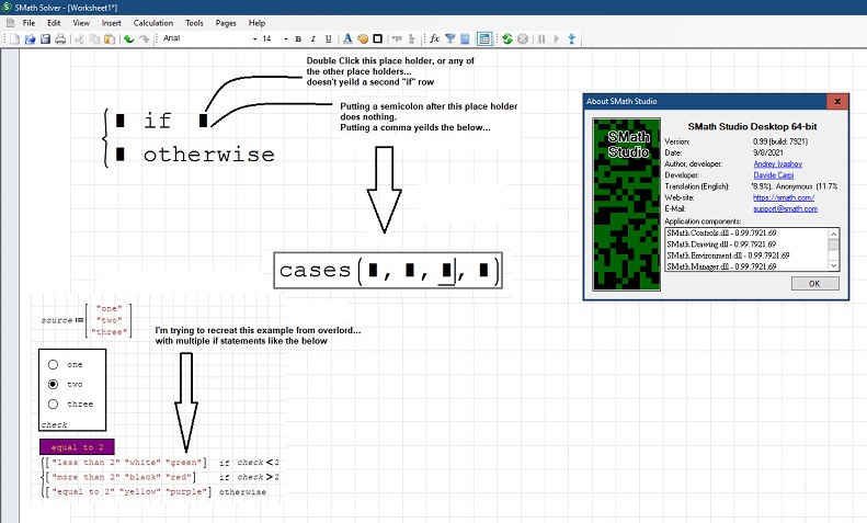

Question 3: Re cases function... used in overloards cfl_with_radiobuttons.sm early in this thread...
- I created a CFL and for the placeholder...
- I created a cases function but it only created one "if" case followed by "otherwise on the next line...
How to create more if cases? (I banged on it and made numerous attempts and scanned the custom functions thread... but no joy.)
Thanks
1. Get the basic if/otherwise [Cases]
2. Click on the the RHS place holder
3. Enter twice
#14 Опубликовано: 16.11.2021 01:14:48

Question 1: Is it the latest SMath version?
It is latest.
Now we have Solver and Writer.
Solver is traditional smath interface.
Writer has more like Ms Word style.
Question 2: where is that checkbox located?
Click local storage in plugin window, there you will see it.
Question 3: How to create more if cases?
Use arguments separator. "," or ";" which of you had set.

Question 1: I must be misinterpreting your instructions... can you advise?
On that place holder top right ... double click coma keyboard
Try it ... Cheers ... Jean.
#17 Опубликовано: 16.11.2021 14:46:09
555 сообщений из 1333 понравились пользователям.
Hit comma again, a new ifline shall be added to cases.
My argument separator is semicolon, so don't be confused.
According to your screenshot, yours is comma.
cases()
Question 2: must I delete the plugin and re-download/install it?
Not need to delete.
Plugins shall be automatic updated.

Da Da!
(Credit to overlord and Jean Giraud for guiding me along the way.)
CFL_RadioButtons_Step_by_Step.sm (13 КиБ) скачан 92 раз(а).
Hopefully this step-by-step will help other newbies.
PS Let me know if I made an error... but it looks to me like it's working.
This is not an error but it needs a clarification.
Setting column in radiobutton shall tell region which column shall be used for source.
In screenshot below you can see there are two columns of data.
If you set nothing or a nonexisting column, it will take first column.
If you set an existing column, it will use that particular column of the matrix.
