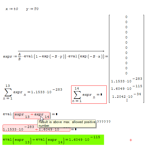

Dear masters,
I'got the error, "Result is above the max. allowed positive number error" during exponential calculation.
How I resolve this kind of errors?
Thank you!
M.S.
my error
exponential_max_err_v0.sm (12 КиБ) скачан 53 раз(а).

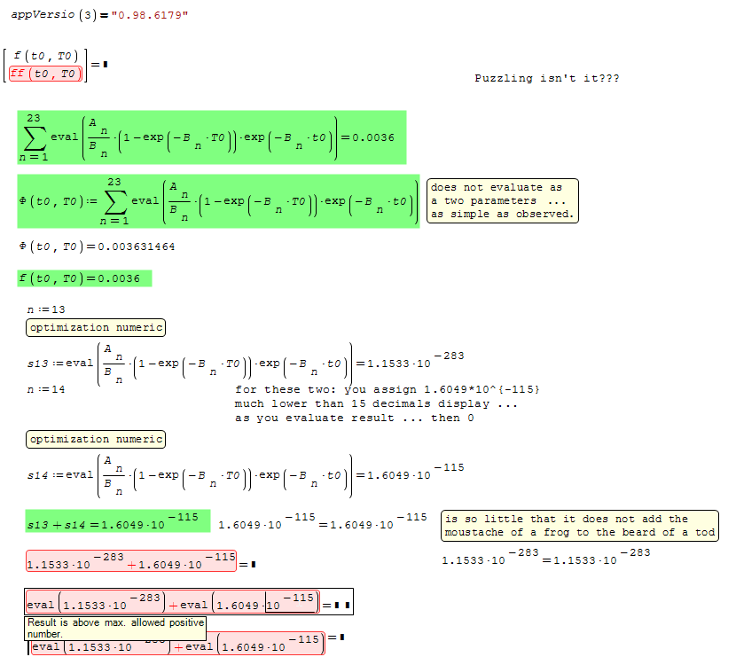

#2 Опубликовано: 09.08.2019 10:09:38
... like this: index 'j' to de-confuse 'i' imaginary.
exponential_max_err_v0.sm (12 КиБ) скачан 43 раз(а).

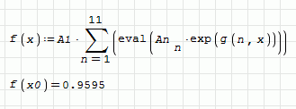

Hi. Summatorie ranged have some issues. For instance, the range variable isn't local. With eval you can get punctual results, but this version can't be plotted, and I don't know why:
Whith this other version you can do both things:
Hope that this helps.

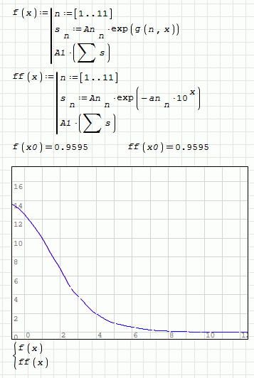

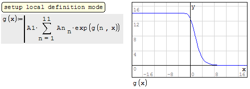

#4 Опубликовано: 10.08.2019 09:08:37
... more doctoring in the *.sm attached
1. local definition mode
2. index piece wise
exponential_max_err_v0 (1).sm (24 КиБ) скачан 45 раз(а).
#5 Опубликовано: 10.08.2019 09:39:30

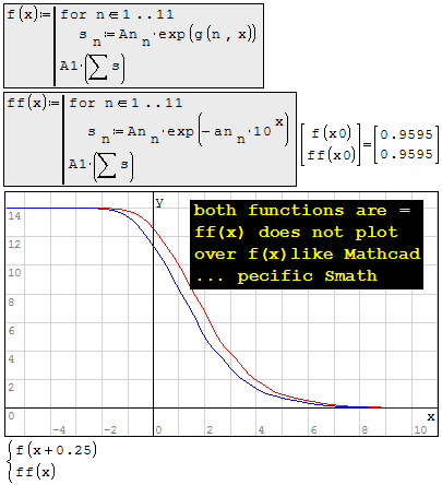

... code this to the previous doctored document.
Summation operator is very capricious, but works
and plot scalar as demonstrated. Plot scalar for
lot more involved stuff [Budapest 39, Legendere ...]
Remember Alvaro: you doctored my Barnes Hypergeometric !

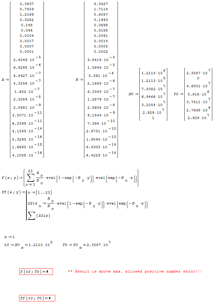

I am getting error "Result is above max allowed positive number",too! And l don't know how to solve it.Function error

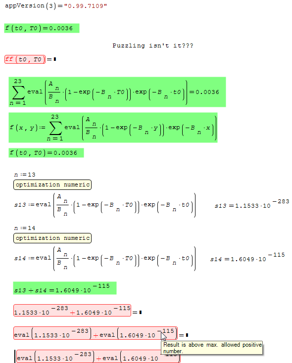

#9 Опубликовано: 13.08.2019 04:35:54
325 сообщений из 2052 понравились пользователям.
I think something is wrong here in the numeric/symbolic engine of SMath which causes those errors.
Version "0.99.7109"
I can not understand this . The error message is quite confusing. The result is quite a small number close to zero. On the other hand, by mouse hoovering the vector it could be seen the fraction presentation of the numbers (symbolic engine) with quite large numbers in the denominator. Therefore the message about max. allowed positive numbers. I think something is wrong in the floating point arithmetic in SMath numerical engine or at least quite problematic. It seems that eval() must be used extensively in order to escape from these traps and to avoid the symbolic engine to make a mess here.

#11 Опубликовано: 13.08.2019 11:03:24
Version "0.99.7109"
From observation in many more SS 7109, the indexing is freaked.
Doctored in pink SS 6179.
exponential_max_err_v03.sm (17 КиБ) скачан 44 раз(а).

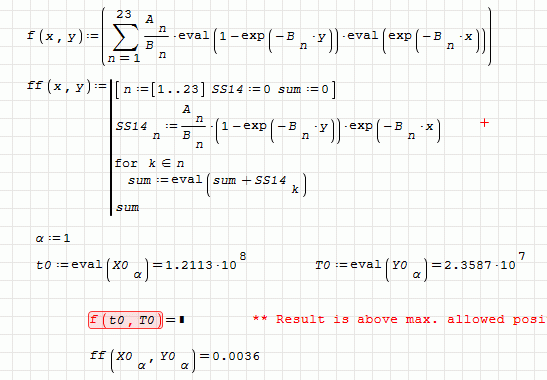

#15 Опубликовано: 13.08.2019 16:19:16
Still confused...
Doctored a bit SS 6179 ... No red in No time.
exponential_max_err_v03-corr.sm (32 КиБ) скачан 46 раз(а).

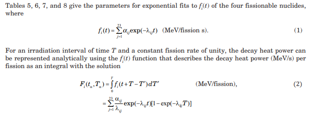

#17 Опубликовано: 13.08.2019 21:27:11
... from there what's next =
... does the suite in green makes sense ?
That mystic formula has to be put in executable maths
exponential_max_err_v03-corr [Next-Suite].sm (160 КиБ) скачан 41 раз(а).
#18 Опубликовано: 14.08.2019 01:17:41
Please, check my interpretation.
exponential_max_err_v03-corr [Next-Suite].sm (185 КиБ) скачан 38 раз(а).

Still red for me...
