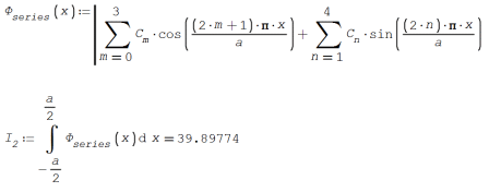

I have an equation that is dependent on the summation of terms and I need to integrate that equation. I can do it if i evaluate the summations myself but I am going to need many terms and was wondering if there is a way to do this without having to evaluate it myself?
I have attached a file of the equation I am trying to integrate.intsum.sm (12 КиБ) скачан 61 раз(а).

Hi Camdem. Use line(...) for prevent the evaluation in Phi.series function. Then, integral could be evaluated.
intsum.sm (12 КиБ) скачан 67 раз(а).

Thank you very much Alvaro

I appreciate what you have said and done so far. Unfortunately, though, the equation is from a series approximation of the equation I have attached. It doesn't come from a data set.
This attached equation is a solution to the diffusion equation with a non-uniform source.

The attachment I was referencing was the picture of the equation.
analytic.sm (2 КиБ) скачан 60 раз(а). Here is the equation in smath.
Sorry about the confusion.

S(x) is the function that the source follows, it defines the value of the source at each point along the distance in the medium and is given for the medium.
On the grounds of integrating the analytic(x), I actually am elsewhere. I am comparing the series solution to the analytic solution to show that the series solution is a good model once enough summation terms are added. In some cases, the diffusion equation will not have an analytic solution and the series solution is necessary to model the system. therefore, I need to show that the series solution is valid.
In terms of other models, I have been instructed to use the series solution that I have.
