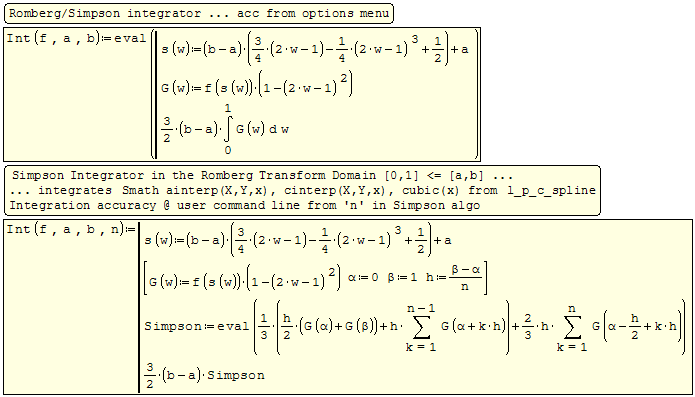

#10 Опубликовано: 14.08.2019 19:07:51
As you can see, Romberg has the virtue of reducing the range of integration
in the [0 ... 1 ] domain. In two versions directly associated with the
Smath native Simpson integrator or Simpson algo style, thus integration
accuracy 'n' @ the user command line.
These two documents are like minimalist tool box.
Integrate Compendium_1 Romberg_FD_Adaptive [Carlos].sm (142 КиБ) скачан 52 раз(а).
Integrate Compendium_21 Simpson-Romberg Merit.sm (138 КиБ) скачан 48 раз(а).
