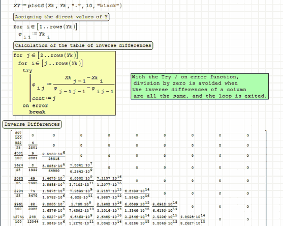

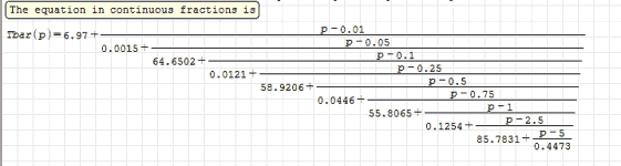

Updated version of Interpolation using the Thiele algorithm in cuntinuous fractions.
It includes the calculation of the inverse differences φ [x0, ..., xi], obtained from the values in the known points
Rounding the values of the inverse differences for the purpose of presenting the equation to make it shorter
