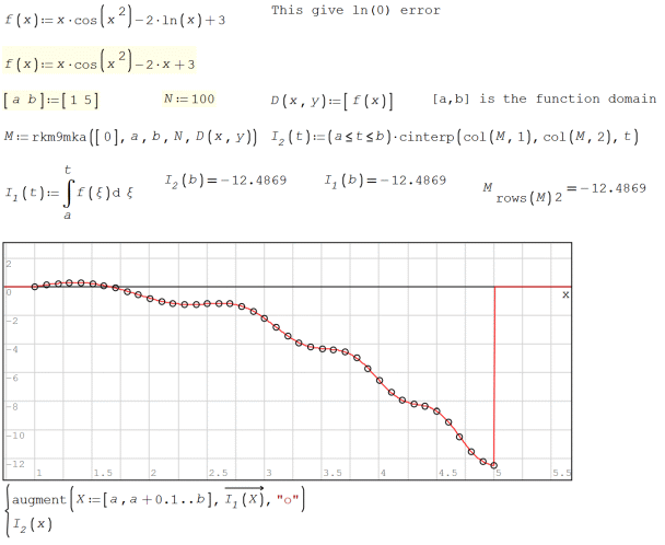

Hi. I can't reproduce this in SMath.
1/1 in Smath 6179, proof: the snippet.

You may not be able to implement the Mathcad bloc Given/ODEsolve.
Hi Jean. Actually not, just the solver, without the given.
I found how to call the odesolver, with D(x,y)=[f(x)].
This method is much more faster than the direct integration.
But remains the ln(0) error, which seems to be a bug in the odesolvers, because zero isn't in the domain range.
Integrate with ode solver.sm (10 КиБ) скачан 78 раз(а).

The zero point is used to determine the dimension of the vector D(t,x) at runtime (D(0, x0)). The size of the system must be determined for the further operation of the numerical algorithm. It seems that it would be correct to substitute the beginning of the interval. I will try to change this. Also, if possible, I will support the one-dimensional case.
