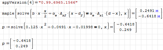

Alternatively you can try maple() function from the Maple Tools extension.

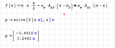

Hi. You need to handle units in the SMath solve function. Here it's a way.

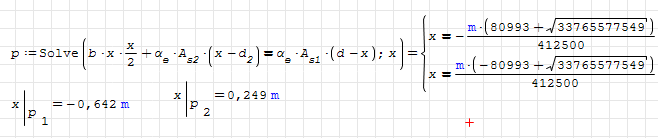

Solve() from the Maxima plugin can handle units directly (symbolic solver)
