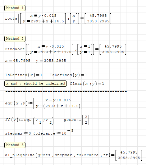

Hi, guys:
I'm a new one to SMath. and have a question on system of equations.
here is a simple question
how to get the result of x, y without using the matrix? I tried solve and findroot, but can't get the value of x, y.
Thank you for the help
Happy New Year!
#2 Опубликовано: 01.01.2022 07:59:32
554 сообщений из 1333 понравились пользователям.
You can't use solve() for nonlinear equations. (more than one unknowns)
You can use roots(), FindRoot() or al_nleqsolve().
Here is your equation solved in various ways.
solvers.sm (10 КиБ) скачан 65 раз(а).

Excellent reply!
FindRoot is better for my condition, I need units.
Thanks Overlord!

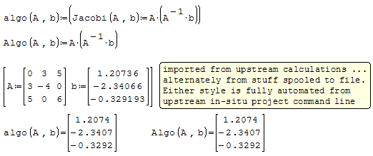

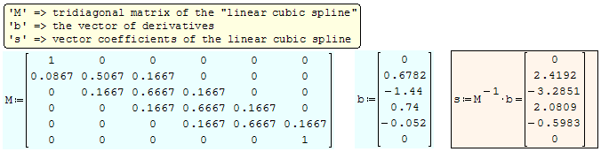

Matrix style is more commonly encountered in Engineering projects.
That example has only one CAS route ... naturally 15 D.
