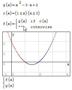

Hi, is it possible to set up interval for the function, which i want to figure in X-Y plot? For example with using if-else or something different. I need to figure only some interval but when i zoom in or zoom out the SMath will stop working.

Yes, it is possible. You can find in the forum different examples like the one I attach to you but also with other modes like if-else.
[albumimg]1456[/albumimg]

Observe the blanking character "

... more useful plot utilities.
2D Plot Range CONSTRAIN.sm (12 КиБ) скачан 179 раз(а).
