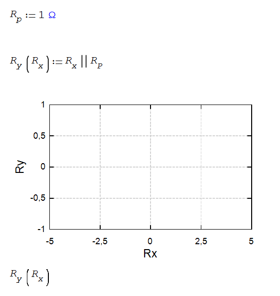

I am trying to plot electrical resistance using Electrical Engineering Library and X-Y-Plots Plugins but it does not seem to work:
Can anyone help me plot this?

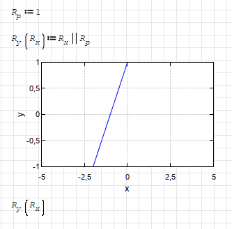

Delete the ohm unit in Rp.
Usually you shouldn't use units while plotting.
For information, this includes most numeric solver functions too.

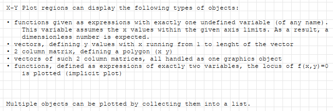

It will plot not only integers, numbers actually.
But plot expect them to be dimensionless.
Not just X-Y plot, built-in 2D plot also.

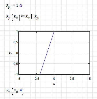

So how did you add the Ohm symbol under the plot? It won't let me add a unit there.
#7 Опубликовано: 17.10.2021 16:23:47
555 сообщений из 1333 понравились пользователям.
1 - Hit multiply after Rx;
2 - (Type W in place holder, place Ctrl+G) or (Click ohm from right pane);
3 - Placeholder shall appear, either double click or press tab to insert Ω as unit.
If you are not typing units after numbers, this is the way.
You can also type ' between step1 and step2.
Units can be typed or chosed with this way more quick.
This will directly open placeholder scroll menu.

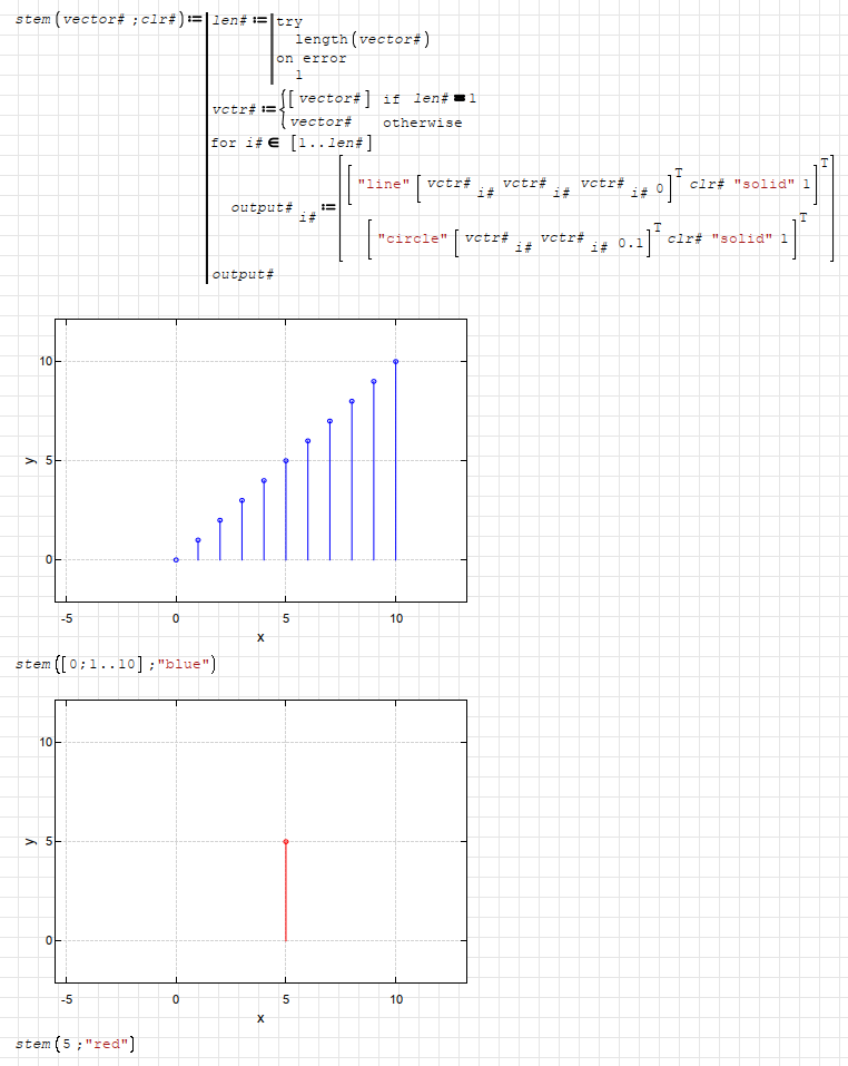

I don't know if there is a stem equivalent for smath plots.
But you can create your own function for that purpose.
stem.sm (8 КиБ) скачан 72 раз(а).

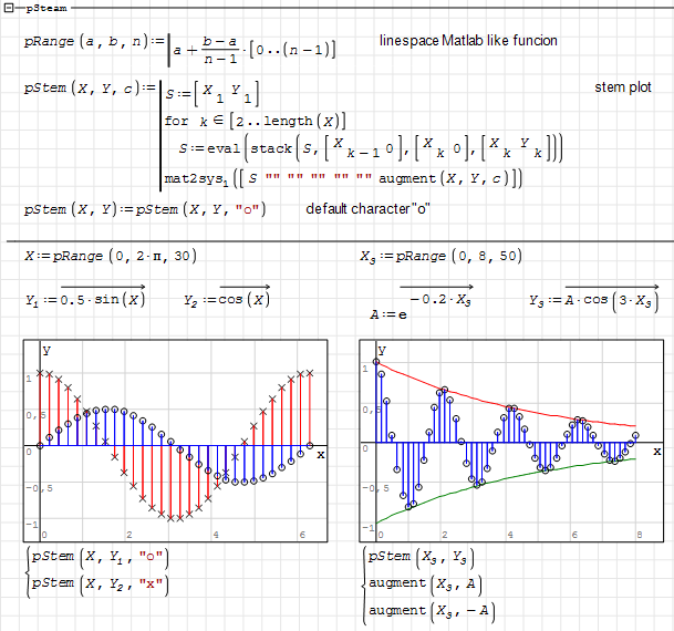

Hi. In addition to the overlord solution, this is another approach.
stem.sm (12 КиБ) скачан 85 раз(а).
