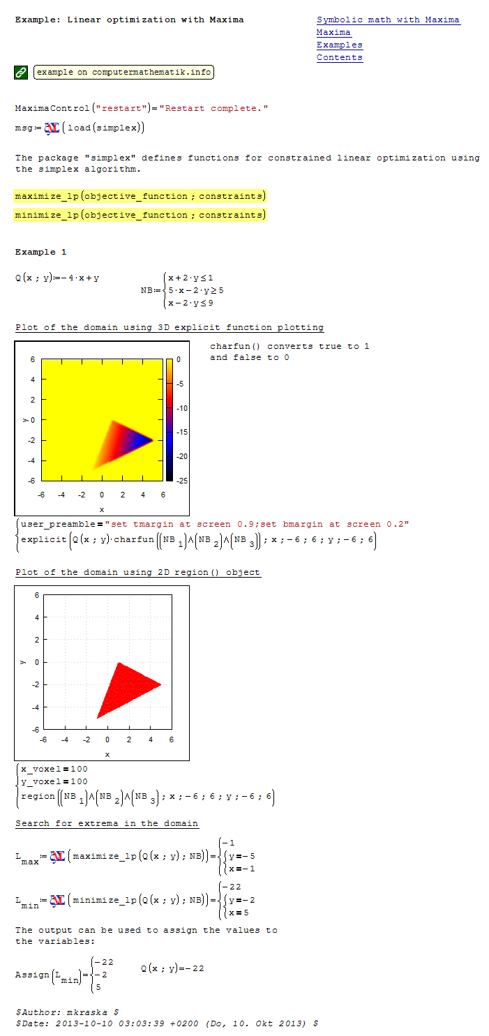

You can use the "simplex" package in Maxima (linear optimization)
See page Examples> Maxima usage> Linear optimization in the interactive handbook.
Example maxima linear optimization.sm (41 КиБ) скачан 89 раз(а).

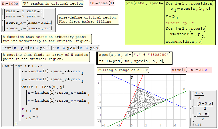

Here is + some extra stuff. Maybe there is way to draw an inscribed 3D ?
Solve GivenFind Critical Region Copy.sm (39 КиБ) скачан 88 раз(а).

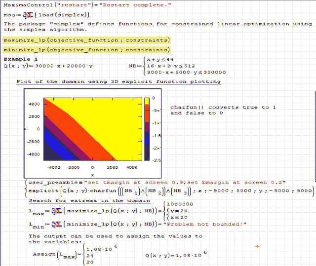

Using Smath Studio with Maxima and the example of Martin Kraska.
Metodo_Simplex.sm (52 КиБ) скачан 81 раз(а).

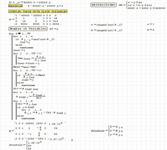

Here is a small and simple Simplex algorithm without the use of the Maxima function.
Small_Simplex_Algorithm.sm (16 КиБ) скачан 83 раз(а).
Carlos
CAUTION: The algorithm is NOT TESTED, but it works well for this example.
It is necessary to refine it so that it work in all cases.

A little Simplex algorithm improved
Small_Simplex_Algorithm_Improved.sm (88 КиБ) скачан 80 раз(а).
Carlos

I'm sorry, I found a bug in the Simplex algorithm.
Now it's fixed.
Small_Simplex_Algorithm_Improved_2.sm (135 КиБ) скачан 95 раз(а).
Carlos
That huge number in the program, can be replaced by ∞ [Smath machine number]
RemToDo => check vs Mathcad
First A[i ... badly indexed.
Small_Simplex_Algorithm_Improved_2.sm (140 КиБ) скачан 83 раз(а).
