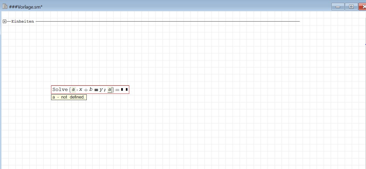

Hello all,
please forgive me if the question is maybe ridiculous.
I want to use the symbolic solver with the maxima plugin, but when I write the equation I get the error that the variable a is not defined.This is correct, because I want to solve for this variable.
Therefore the question which mistake I make here?

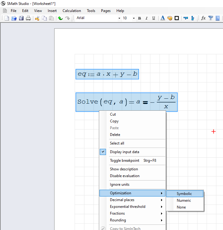

you must force-define the symbolic analysis through a pop-up menu
Davide Carpi 08.07.2021 07:38:00
